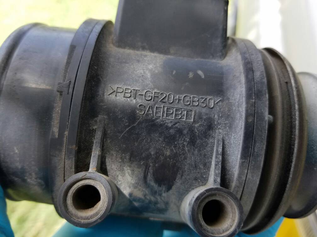

Does Toyota not sell the MAF sensor by itself? When I check online I only find the entire meter assembly for like $630!
I was using this part number: 2225075010
Here's the Denso sensor PN# http://www.toyota-4runner.org/3rd-g...-mica-next-adventure-build-2.html#post2190487
Denso is the OEM mfc for the MAF sensor

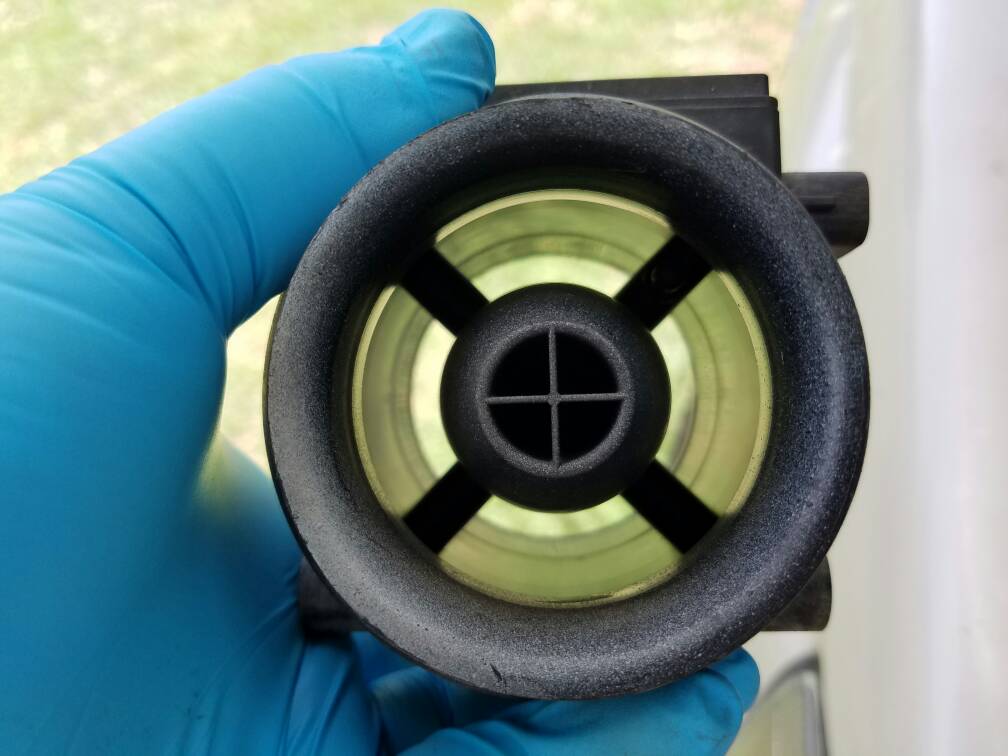

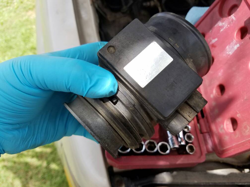

Apparently I have the "wind tunnel" style of MAF. The Denso website does not list one for my 96. Also the current MAF looks to be after market as there are no brand markings.
I cleaned it pretty good, just waiting for it to dry.

That's ok, I appreciate the info anyway. I did find some other aftermarket brands that make the 96 MAF. Cardone, Duralast, Dorman, etc......
Interestingly, after I cleaned the MAF, she started up fine (after realizing it was still unplugged) and I took a test drive. Steep climb did great, O/D is working again. However she did die on me waiting in line at the gas station while hold the brake in drive. I've attempted to replicate it in my driveway but she just won't do it. In drive I'm idling @ 850, in park @ 1200 RPM. Are those good numbers?
I hate using aftermarket parts but funds are kind of low. If I end up replacing the MAF later, what brand is best?

I cleaned it, and that seems to have alleviated most of my idle issues. I'm just trying to plan ahead in case the MAF kicks the bucket. Thanks for the offer.

I would clean the MAF one more time with MAF cleaner as well at the TB with carb cleaner. Also, unplug the EFI fuse while you do it.
