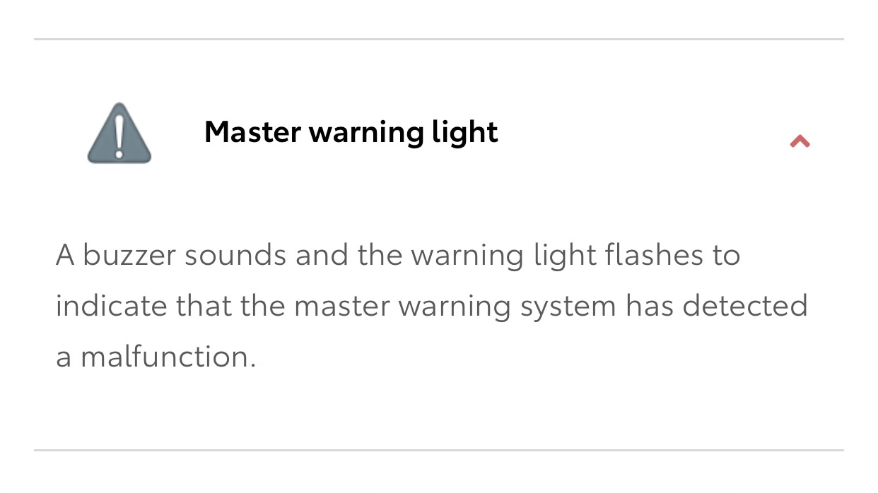

General Info: 2015 TRD PRO, 98K miles, all fluids and maintenance completed on time. No signs of any caps loose such as brake fluid reservoir cap, gas cap, etc. No leaks anywhere. No moonroof.
So I have a friend currently driving my 4Runner because her car was totaled. She’s been driving it for a few weeks now. She reported (while driving up a gravel driveway that has an incline) a symbol popped up that has an exclamation mark inside a triangle and a picture of a vehicle on the information screen on the instrument cluster. She said the message on the screen said Master Warning Light. No buzzing noises.
She said it happened twice. Vehicle currently drives fine. Did a scan with my BlueDriver and no codes popped up.
Has anyone experienced this with their rig?
I was not present at the time so I am limited with info that I can give.

She picks up my daughter and cares for her. So the benefit is my daughter’s safety and getting her to school on time. My 4Runner is replaceable.
Ok found out one of the rear passenger doors needs a little more love to close. So it was most likely the cause.
