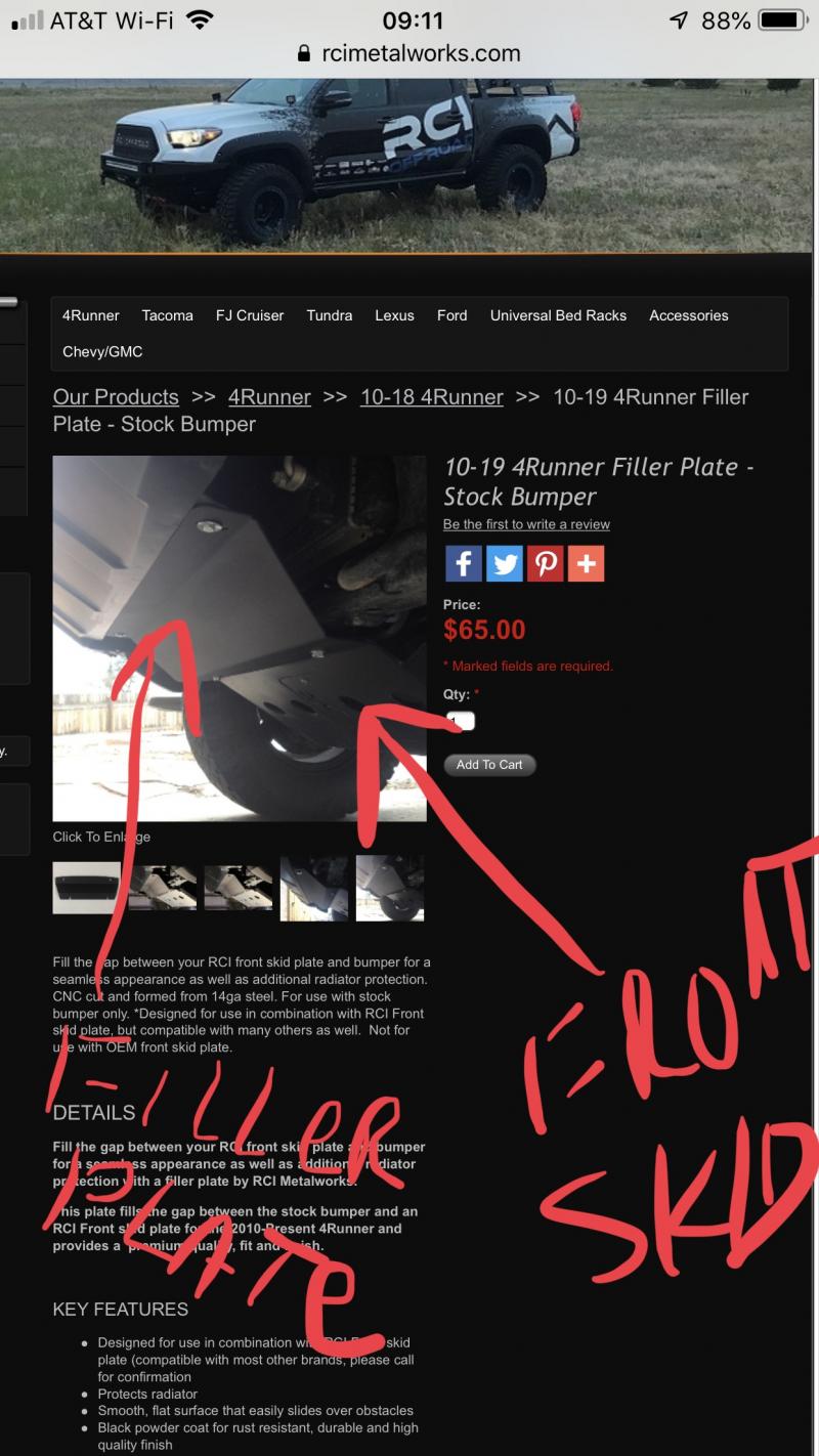

The filler plate is to cover the radiator, and mates to the front skid and the bumper, not the tranny skid that sits more rearward.
From the RCI website -
We are very excited to announce the TRD Integration plate for TRD Pro owners who would like to use their TRD Front Skid Plate and tie in seamlessly with the RCI Transmission and Transfer-case plates. Built of 1/4” laser cut aluminum, it protects the front differential and oil pan, and is the only one of its kind.
Maybe I threw you by calling it a filler plate. Either way thanks for the responses, I got the answer I was looking for. I had full steel on my 14’ TEP but the guy I bought my 17 ORP from had added the TRD skid.
