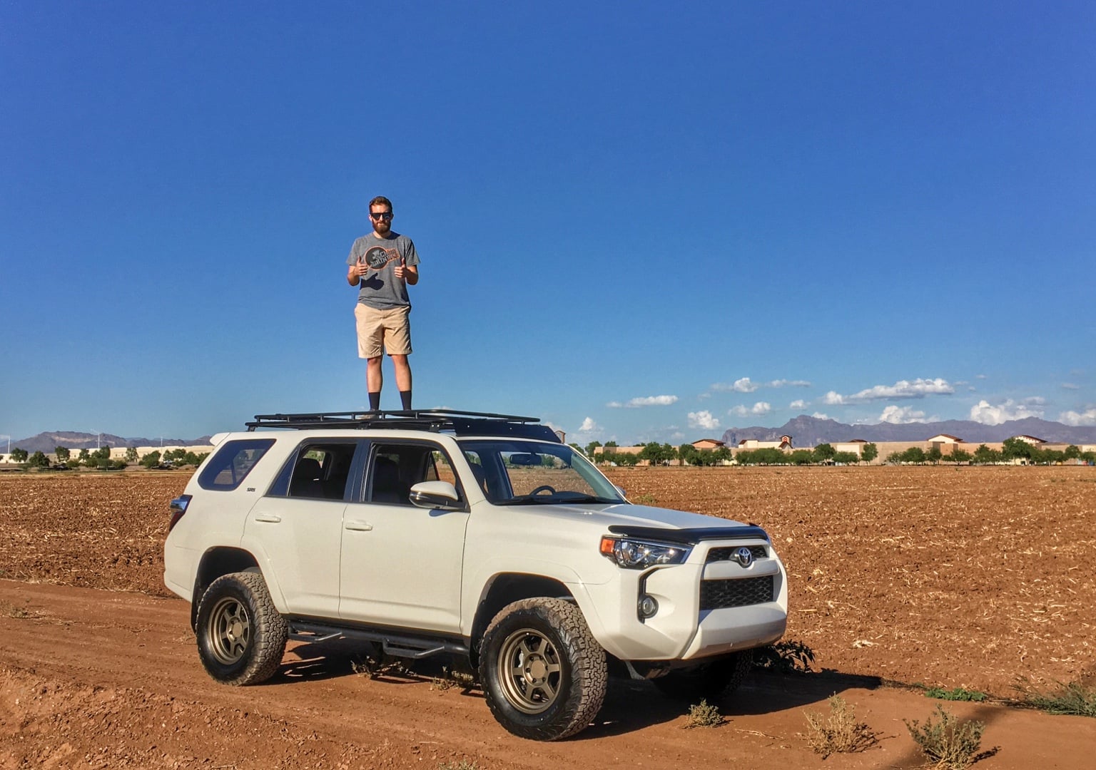

How she sits as of 8/2017

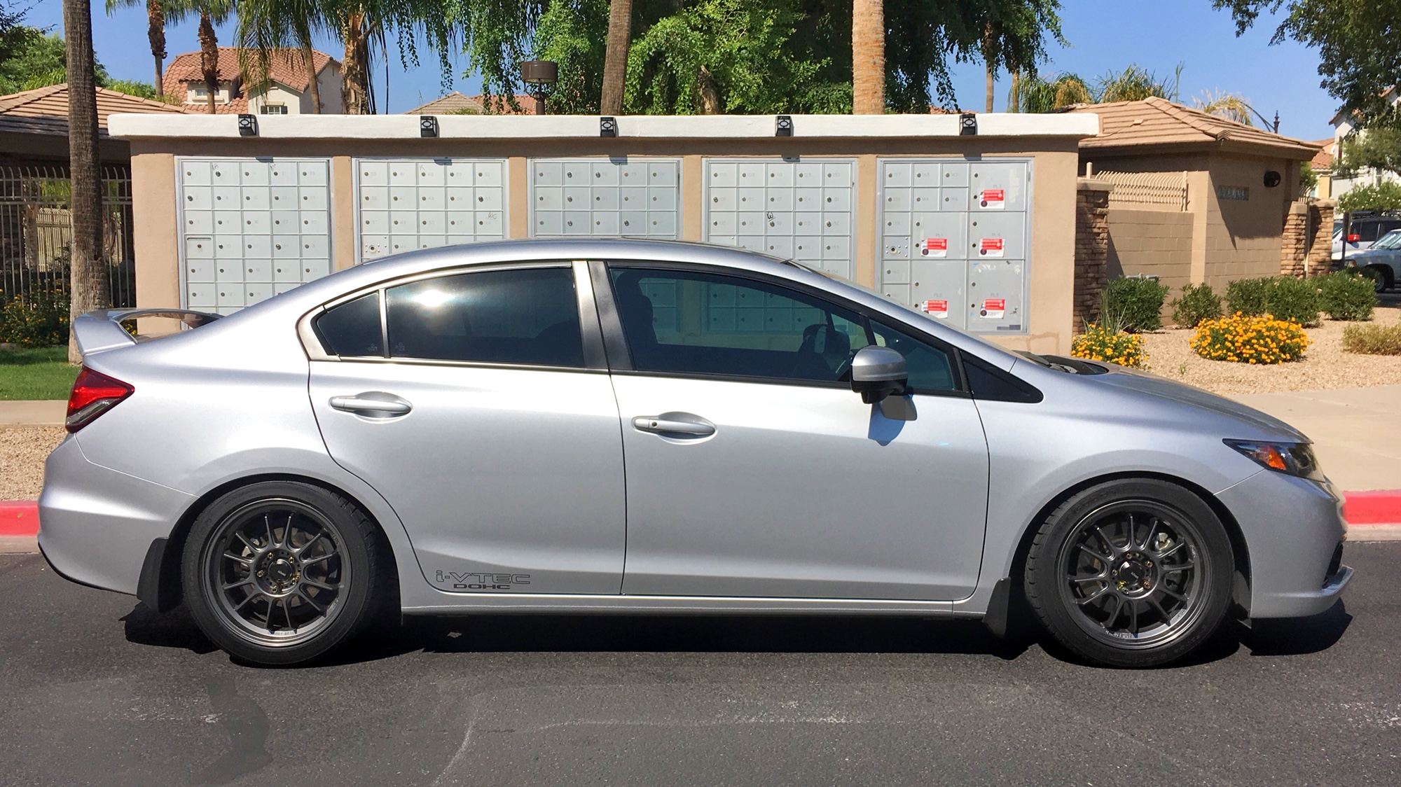

My car

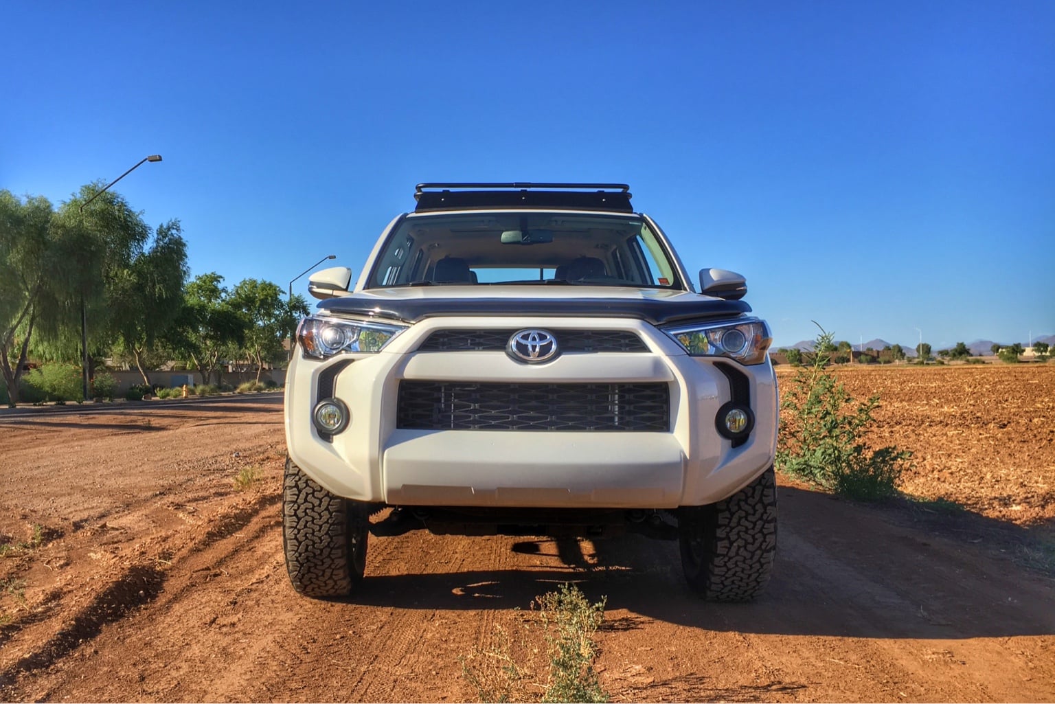

SUSPENSION
- Bilstein 5100 struts front and rear (fronts set to 0 lift) all lift provided by OME coils
- OME 883 front coils https://wheelersoffroad.com/product...emu-244881/old-man-emu-2883-front-coil-set-2/
- OME 10mm strut TOP spacers (2.5” lift total up front) https://wheelersoffroad.com/product...7513/old-man-emu/poly-10mm-lift-enhancer-kit/
- OME 2895e rear coils (2inch lift)
https://wheelersoffroad.com/product...n-emu-205552/old-man-emu-2895e-rear-coil-set/
- 1 OME 10mm trim packer (driver rear only) to compensate for the Toyota gangster lean (based on my measurements this is a real thing and this $16 piece corrected it.
https://wheelersoffroad.com/product...-205552/old-man-emu-150pr10-rear-trim-packer/
WHEELS/TIRES
- FN Wheels Countersteer type X (bronze), 17x8 -10 & locking black lugs
BFG KO2 265/70 Load C
EXTERIOR
- Optimum Opti-Coat for long term protection since replaced with Menzerna PowerLock sealant topped with Collinite 845 insulator wax
- RCI Aluminum front skid

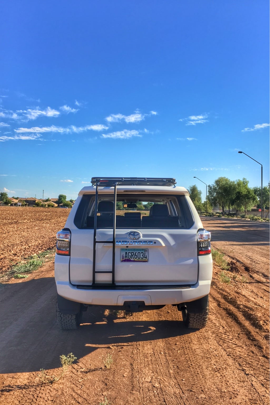

- GOBI stealth rack with no-rise option, sunroof cutout and movable crossbars
- GOBI ladder
- AVS hood visor (so awesome and it doesn't touch the hood, it bolts to the underside

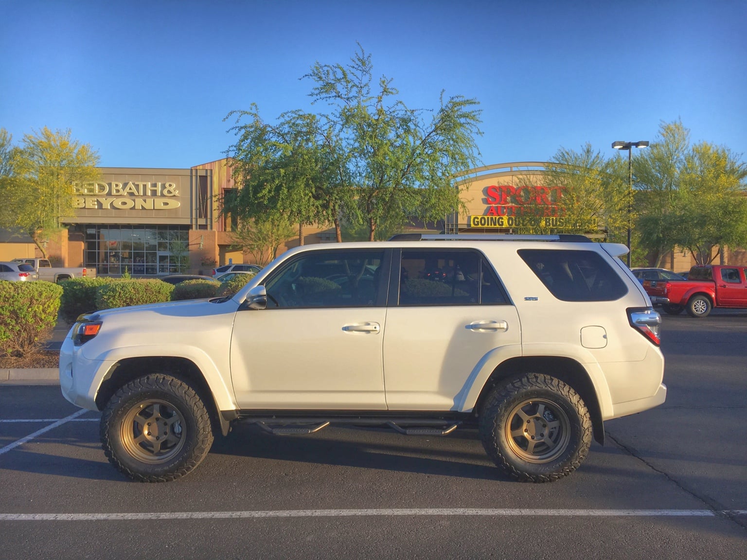

- NFAB side steps (I want sliders but my wife needs steps as this is her DD)
INTERIOR/lighting
- TRD PRO shift knob
- Weathertech floor mats front and rear

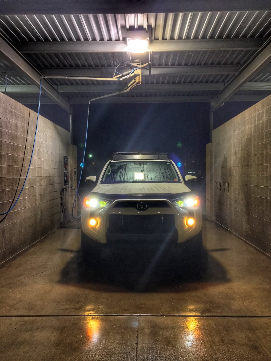

- Theretrofitsource Morimoto 55w 4300k Xenon low beams
- NOKYA yellow halogen dogs and NOKYA yellow DRL/high beams (looks really cool and it is actually really functional, especially in poor weather conditions)

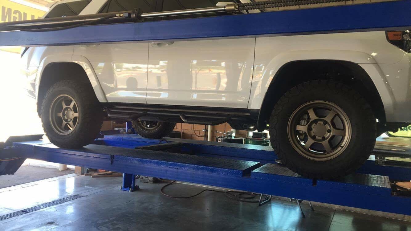

The day I installed the bilsteins (but not the rear coils)

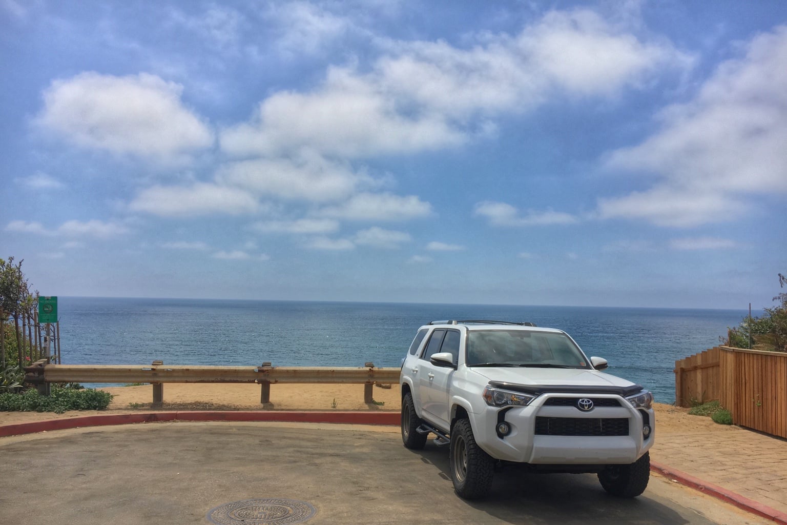

Somewhere in Del Mar on vacation

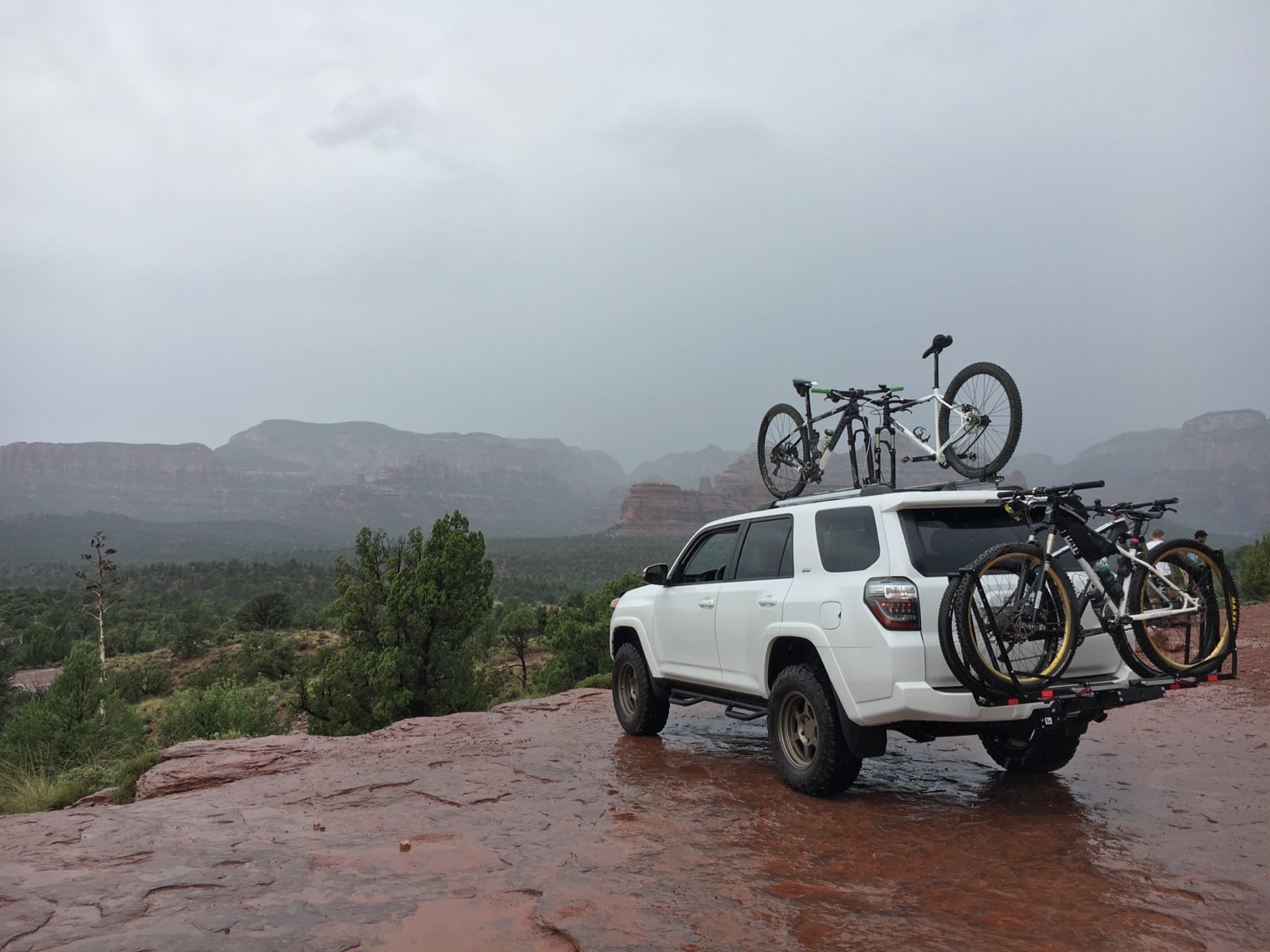

Random Sedona trip with some bro's

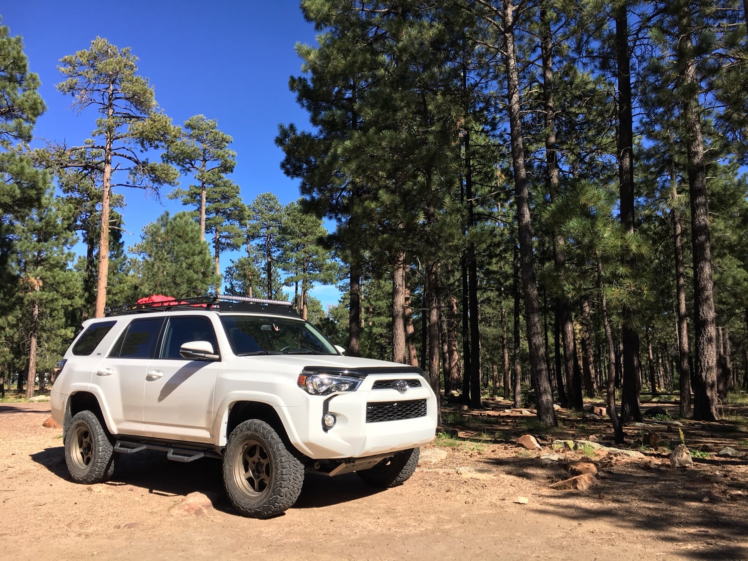

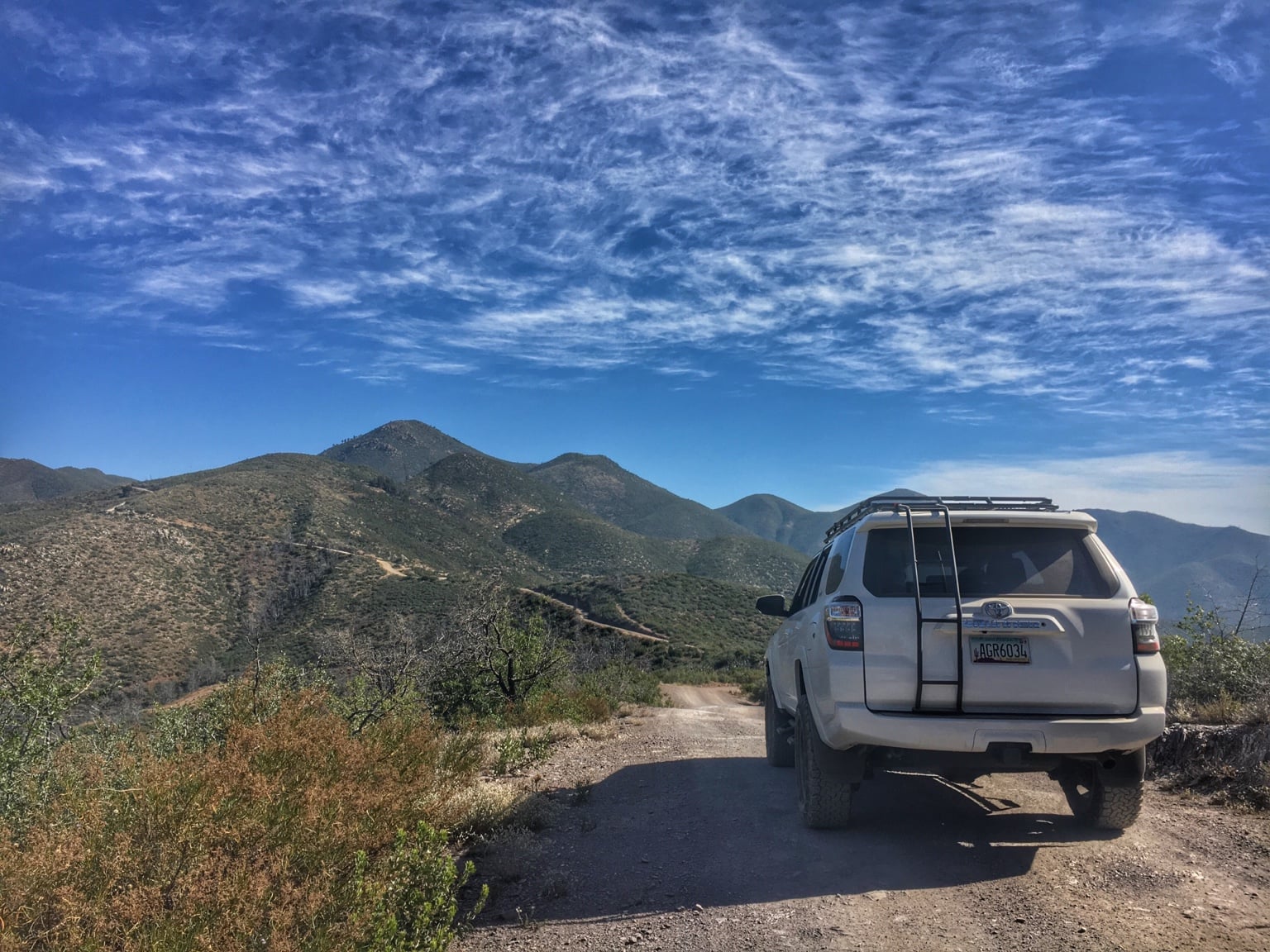

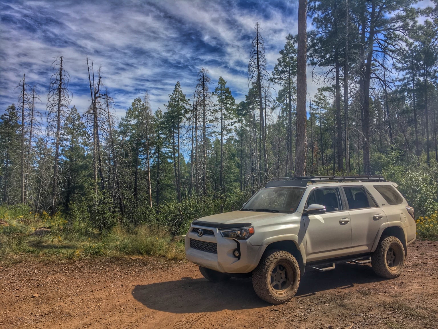

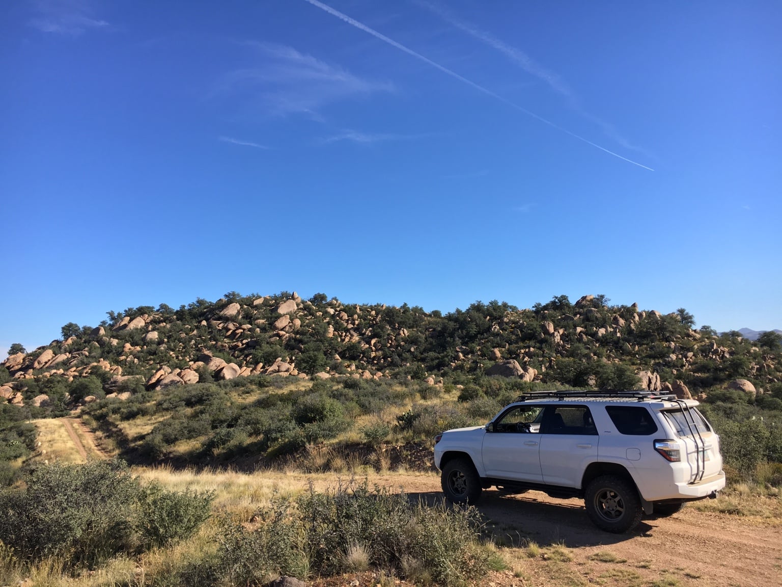

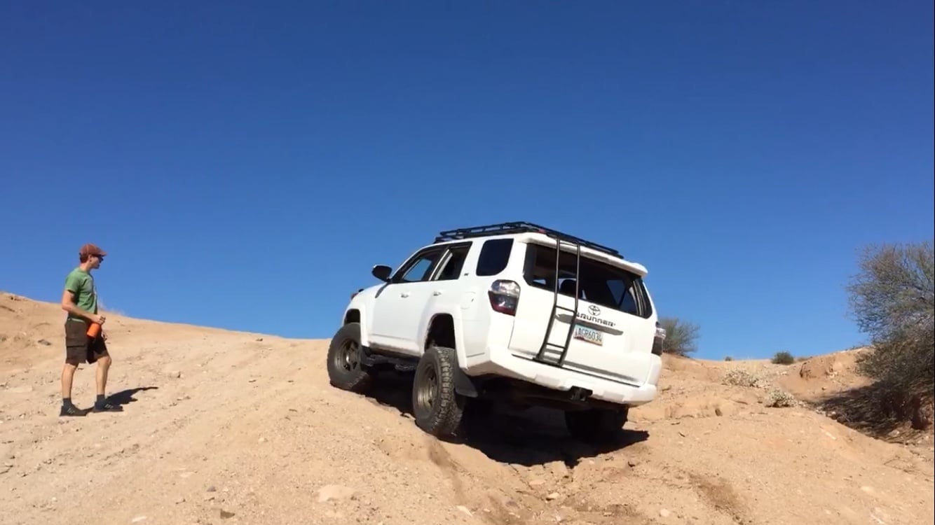

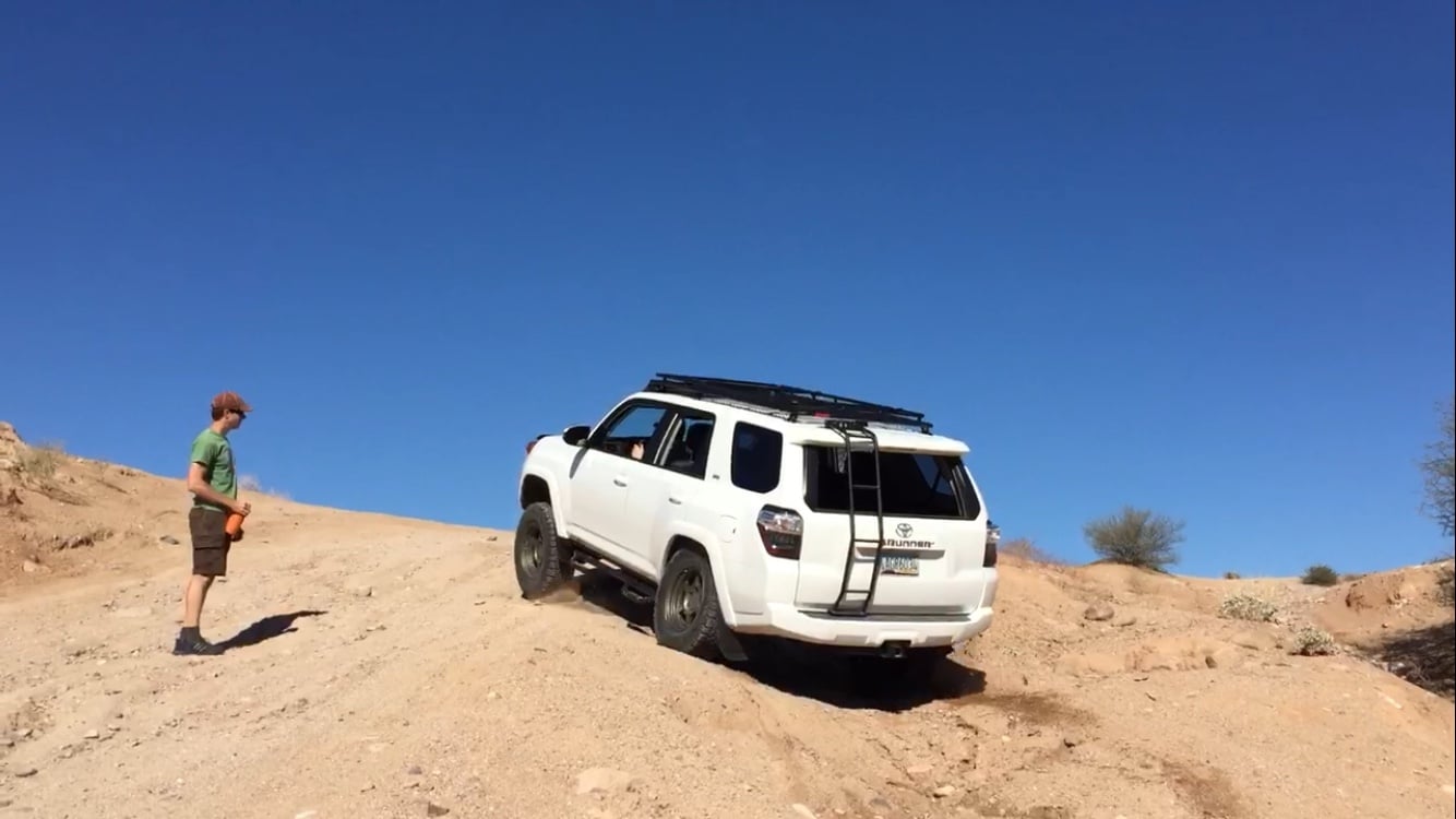

Random wheeling pics
Some poor quality flexing shots

The truck looks great. I like the wheel choice with the white truck. Envious of your roof rack haha.
Thank you, I'm pretty burned out on black wheels because everyone runs them. I've always been a huge fan of bronze and IMO it works on all paint colors. The GOBI is sweet, worth the wait & it makes a lot of sense for us because if we use our 3rd row, we don't have much storage space at all & the rack allows for that.

Those N Fabs make me cringe. If you are doing any sort of real wheeling you may want to switch to something that bolts onto the frame. Hate to see your truck damaged from the mall bars pushing up to the sheetmetal :shocked:
Other than that she looks gorge!!

So crazy to see Sports Authority out of business

Yeah I do understand what you're saying. I hate them but they are really practical for my wife to get in and out and it's her DD... so I'm just extra careful when i wheel. Any suggestions on sliders that can double as steps or possibly a better option for steps that bolt to the frame?
Did some wheeling today with my sister in law and my buddy. His Blue JKU is pretty sweet, id still take a t4r any day over it but check it out.
