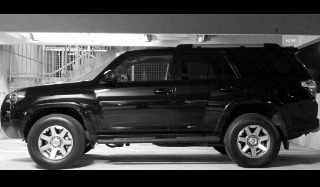

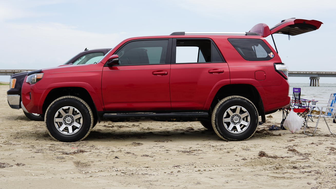

I'm running 2.5 in the front and 2 inches in the rear. I know it's not the exact setup you're looking for but, for reference. Ill be going for 285 or 255 skinnies in the future though.
Here's a .gif of a stock one I parked next to along with mine.
