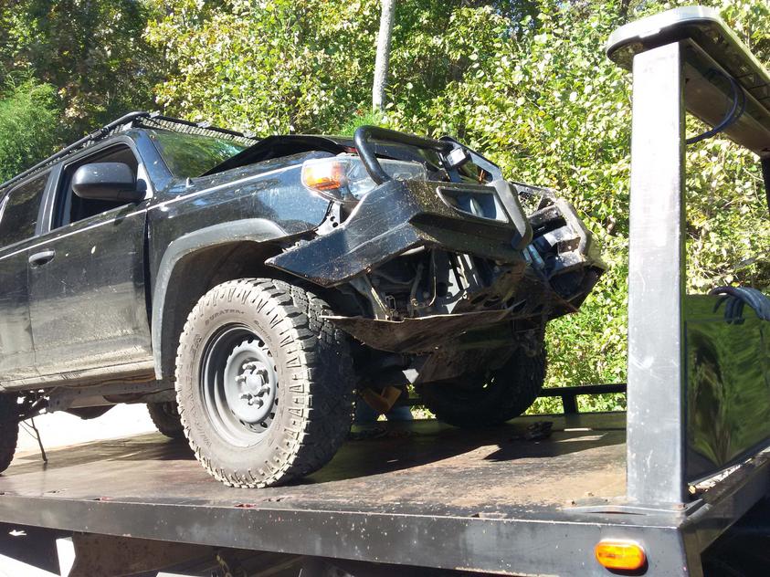

Can you provide pics of the side view and interior? I am wondering what the cabin looks like after the impact.
I have been reading and I am a little confused over the bumper issue; did it assist more or less in protecting the occupant(s)? Or is there just not enough info to say? Or is the difference negligible/depends on wreck?
It help mitigate the damage to the vehicle, but the ARB is designed to buckle similar to the factory design so it probably causes more damage than say a Shrockworks or Demello in a higher speed impact; but still far less than would be present should the factory items still be installed.
At 50 mph into something like a big tree the deceleration change of the vehicle over time was probably not much different than a stock bumper. I also doubt that the damage was any more or less than a stock bumper.
I will say that in a crash such as this, I would rather be in a vehicle with a stock ARB or even stock bumper versus a more solid or thick bumper. Low speed hits are one thing. High speed hits against immovable objects (even though he moved it a few feet) are something else entirely. In a crash, the speed and the object you hit are the key factors.
That's true, assuming for a minute that had his bumper not taken much of any damage (as well as the rest of the vehicle) the force transferred through the crash would have continued through the vehicle and occupants. Its really a case of the sudden stop being what kills you.
The crumple zones being designed to absorb impact energy and assist in not only reducing the velocity of the vehicle but its occupants, this means that without those considerations the occupants will also still be traveling at a high speed and our organs are not as tightly bolted in as say a dashboard.
Very good answer! Its all about energy. When you hit the brakes, you get rid of the energy of motion through heat in the brakes. In a crash, the energy is scrubbed off through crumpling of the body. If parts don't crumple, it will just be transferred to the occupants. Going from 50 to zero is tough on the old body and as my friend so eloquently put it, your insides aren't bolted down like a dash. Just imagine if you had a completely rigid vehicle that did not crumple in a crash at 50 mph. The vehicle would be fine, the seatbelt would cut you into three pieces.

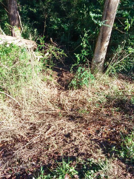

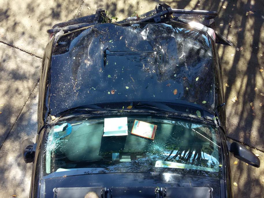

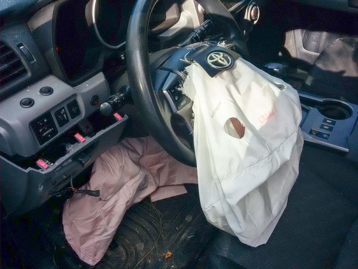

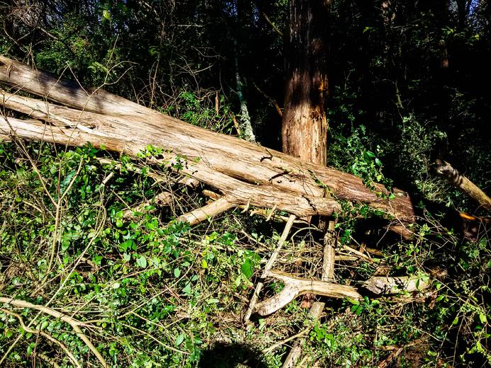

She was towed away Saturday... I'll know more next week. Meantime here are some more pictures.
