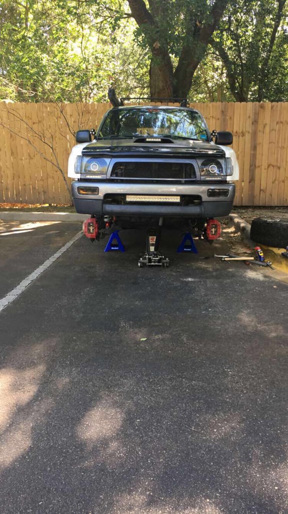

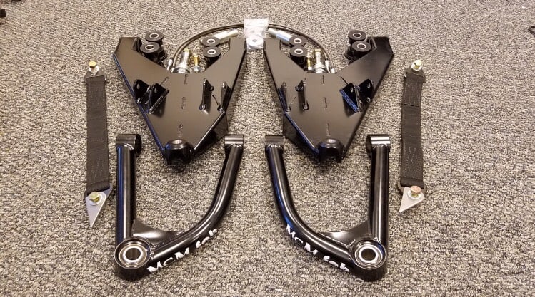

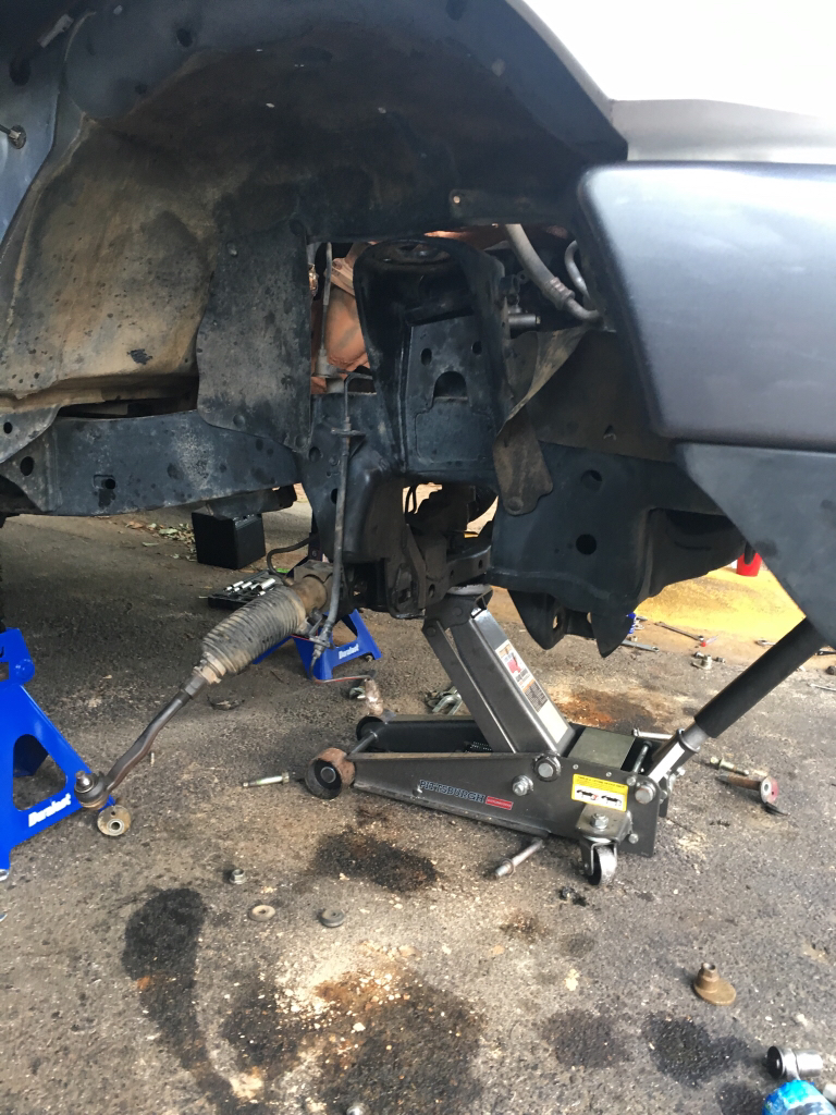

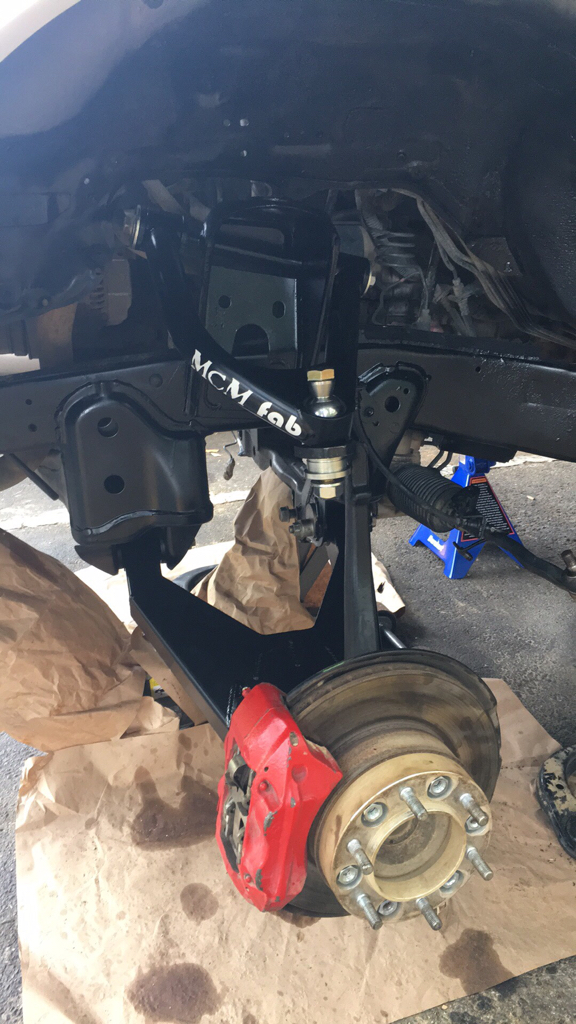

I’m a full time college student and currently live in an apartment complex about 5 minutes from school. I completed the install over 2 days and 25 hours of work in my apartment parking lot. If that isn’t a testament to how easy and well-designed this kit is, I don’t know what is. No fancy equipment or tools are needed to install this kit. Some 6 ton jacks stands, a hydraulic jack, and your normal tools will get the job done! Here are a few photos I took throughout the tear down and install.

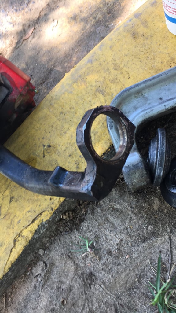

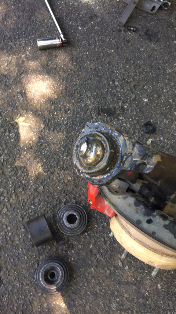

Cutting the stock ball joint to be pressed out
Spindle ready for uniball adapter

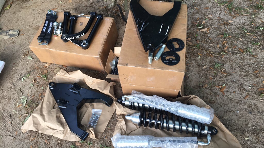

The kit just dropped off by UPS
All laid out
Removing all the stock components
I’m sure my apartment complex loves me
The install

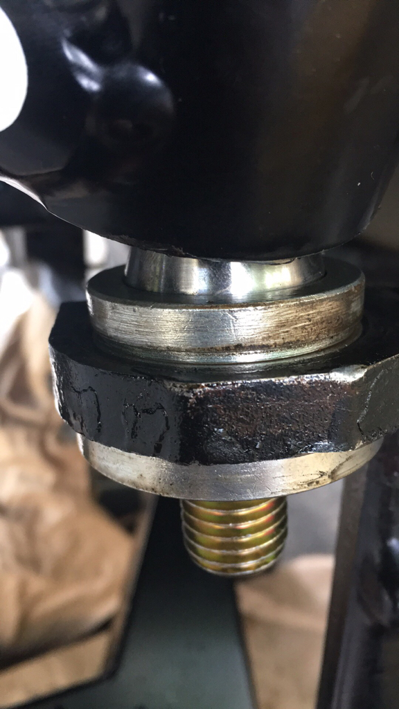

The uniball adapter uses the stock UBJ snap ring

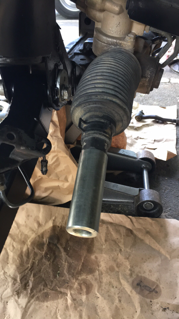

Tie rod extensions (included in kit)

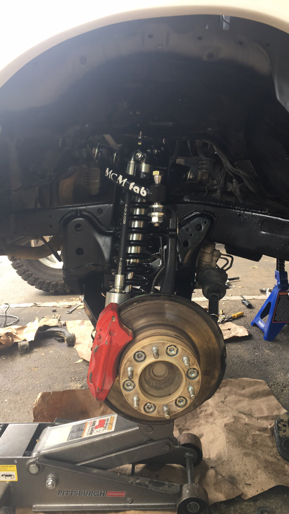

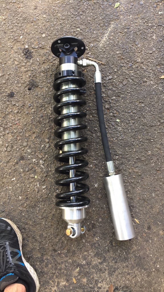

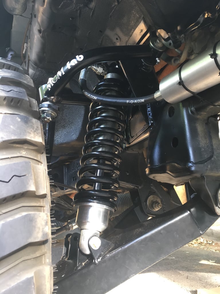

FOA coilovers
Driver side nearing completion
Passenger side completed and sitting on the ground. This was before the truck had even moved so not a great representation of current ride height. Don’t mind the zip ties holding the resis up, I have mounts waiting at home for me!

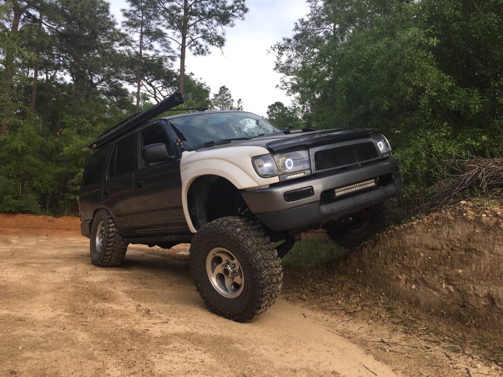

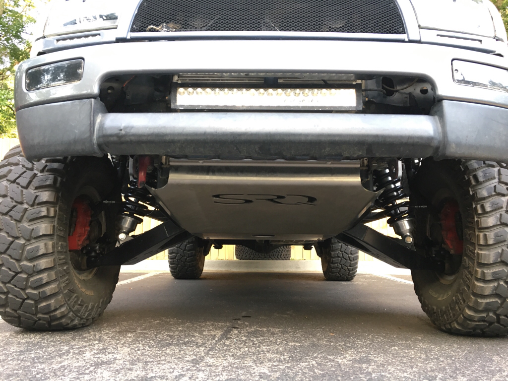

Finished product:
Thoughts so far:

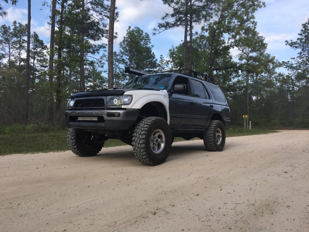

I’ve had the kit for 2 weeks now and couldn’t be happier. Last weekend I drove 500 miles round trip in one day to check out the Yota Mafia meet in Atlanta. Mind you, this was less than a week after finishing the install and I didn’t have a single problem. I’ve only hit the trails once with the kit as I’ve been trying to get a few miles on it before I start testing its limits. Being that the 4runner is my DD, the miles are already racking up quickly. I should have over 1000 miles on the kit by the 2nd week in May. Next weekend I make a 350 miles trip home to visit my parents. While I’m down there I hope to have time to cycle the suspension and get some travel numbers. I also will be ordering hydro bumps, TC spindle gussets, and TC cam gussets. I have the coilovers set as low as I can and the front end still sits slighty higher than the rear. Since I am 2wd 2.7L I don't have much weight up front, with the being said I plan on getting some 500lb springs to swap out for the current 600lb springs. I really hope to dial in the kit over the coming months along with redo my rear end which is in need of a huge upgrade.

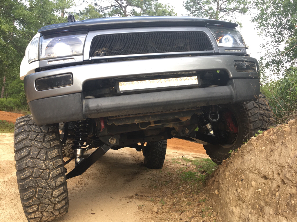

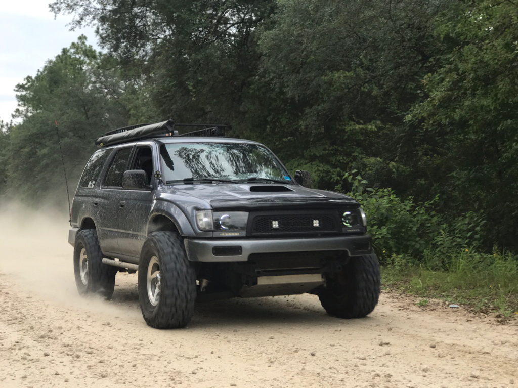

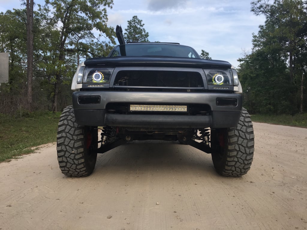

A couple shots of George's Tacoma rocking this LT kit.
With long travel, a lot of the hardcore baja types will add a second shock up front. You add the hoop above the uca, and then add the shock to the hoop and second mounting position I believe.
