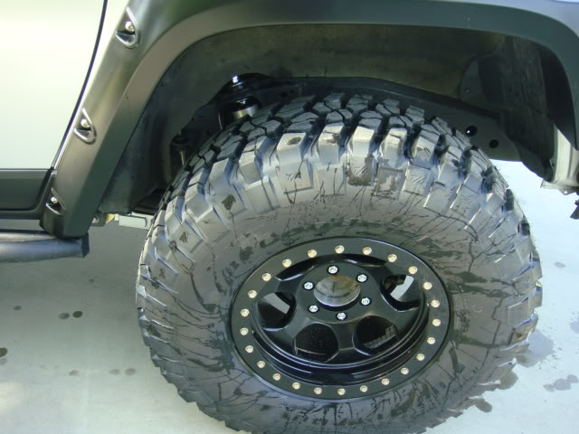

Thanks for the link. I'd still like to see the black M/T Classic II, especially on a black T4R. Here's my wheel of choice, hence why the M/T's aren't first on the list:
Robby Gordon Wheels

Thanks for posting the pics. I love the stance and look of the rims. those Robby Gordons are pretty sweet too.
