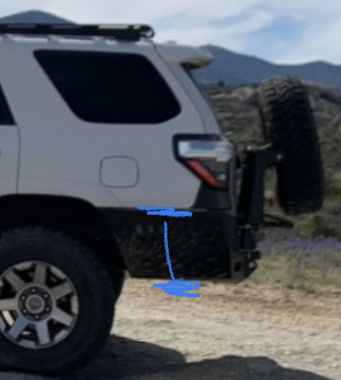

Anyone have the measurement for how tall the bumper is top to bottom in this location. Looking for the vertical distance not bending the tape around the curve of the bumper. Maybe measure it at the rear edge of the gas door.
Thanks!
Thanks!
It looks like you are measuring the top of the c4 bumper which is the same as the seam that is already there from the factory. If you're looking for something else let me know and I'll try to measure for ya'll.

Yes. Interested to compare the c4 bumper height to stock. The stock bumper measures 18” tall directly below the right edge of the gas lid. Want to see how the ground clearance changes vs stock bumper just behind the wheel which is why I’m asking.
From the right edge of the gas cap straight down without following the curve of the bumper (vertically), it's 13.75" to the edge where it angles in about 30 degrees, and a total of 15.25" to the absolute bottom of the bumper. However, the hitch receiver hangs below that by about 3". The hitch on the C4 uses the stock mounting location so in that area there is no clearance gain. The hitch receiver on the C4 is removable FWIW.

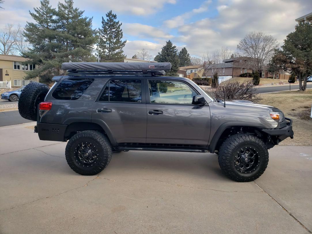

I attached a photo of my rig (forgive me it's pretty old) you can see pretty well how much clearance you gain. It would depend on where you're comparing measurements because the stock cover in that area slopes lower towards the rear tire.
Short answer, if your measurement of 18" is correct, about 3"

Thanks. Exactly what I needed. I won’t be using the hitch. I’ll re measure my stock cover since you took some pretty specific measurements for me!
