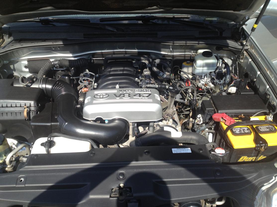

162k miles! Runs as good as when I bought it with 72k. Give it a nice wash every once in a while with some simple green and still looks great!
