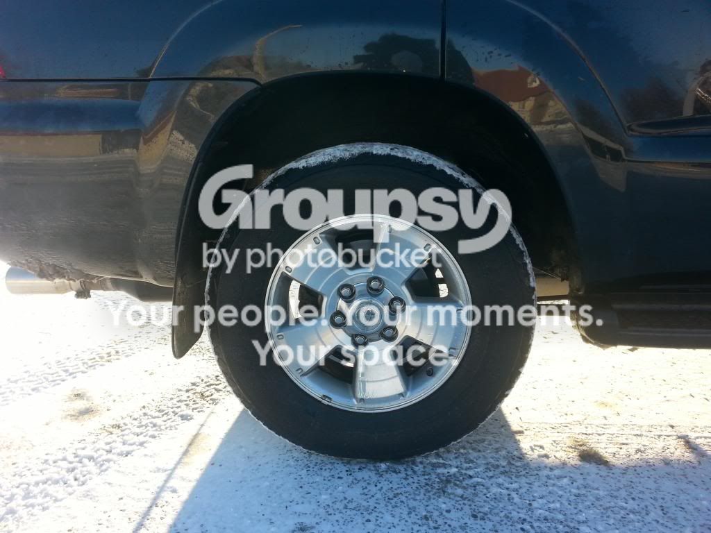

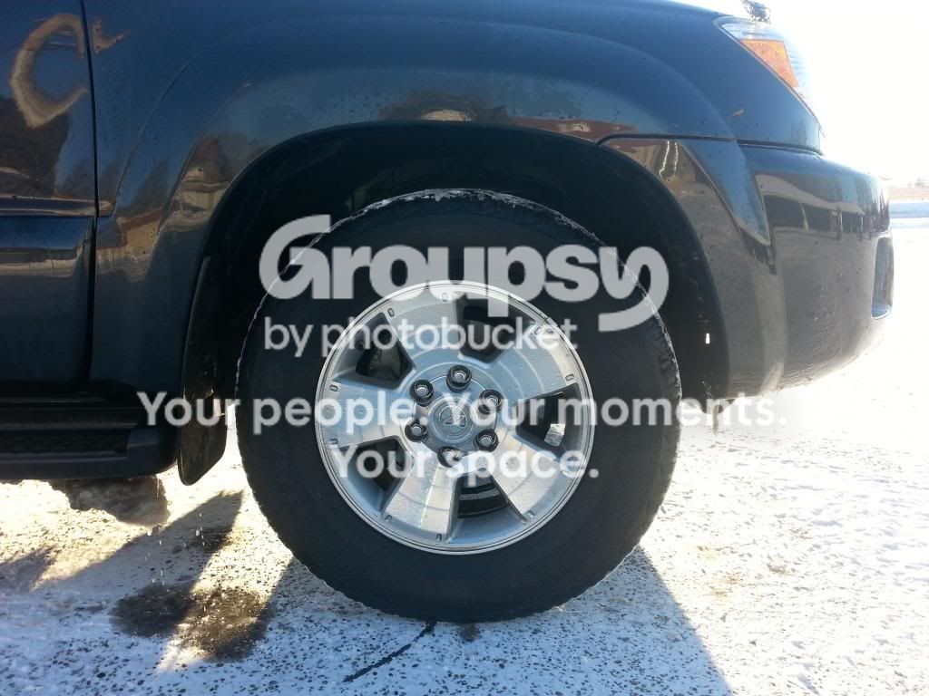

These pictures are pre everything. I decided to install the lift last night in my cold ass garage covered in salt sand and every other grime you get with a first seasons snow.
[/URL]~original[/IMG]
And now after the lift:
Bilstein 5100's set a 1.75" with FJ Springs all around and FJ Bilstein shocks in the rear with a daystar 1.5" spacer.
Tires are BFG KO's LT275/70R17.
The tires fit well. No rubbing during driving, but when parked the tires touch the UCA at full lock. Will drive for a few days and check the liners for rubbing.
Also installed the RCI front and tranny guard.
I did not get a chance to do the measurements.
