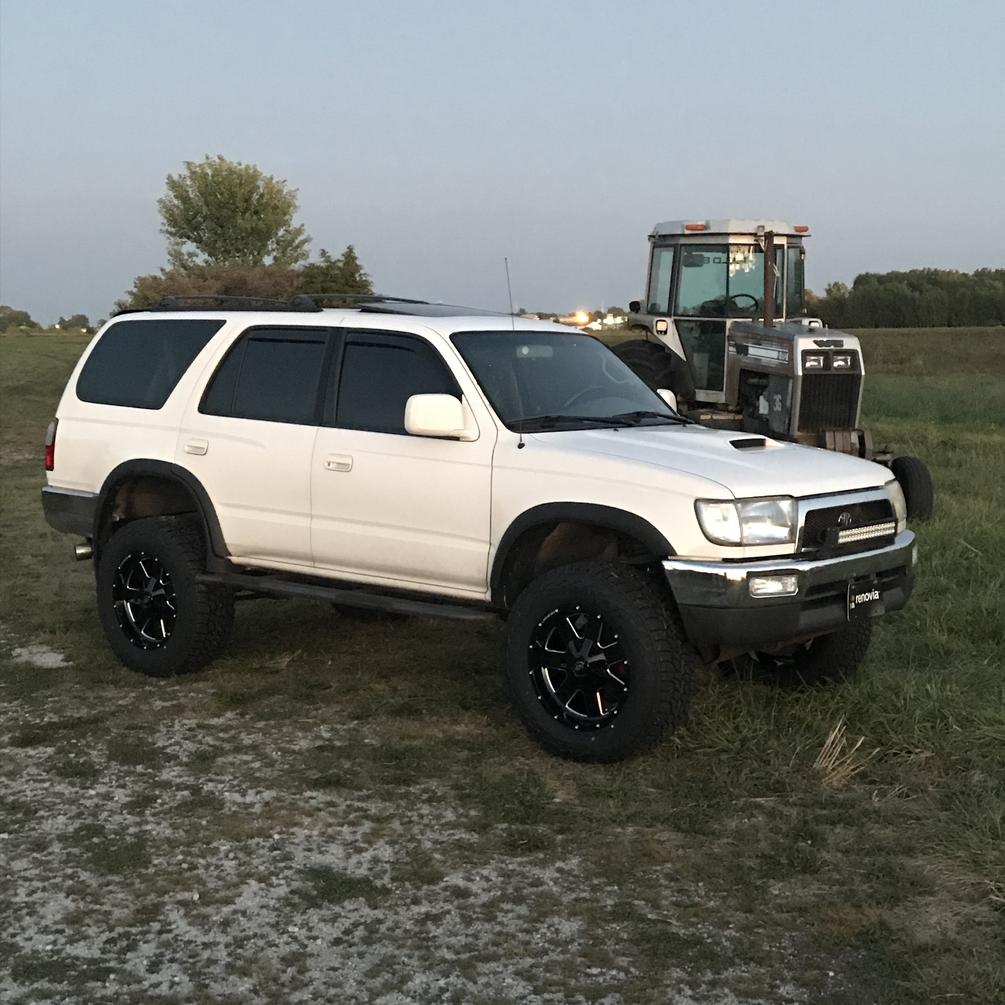

The most recent mod was the lift. After months of deciding which one to do, I decided on the TRD/OME lift. I looked for a month or two and was able to score a set of TRD Tundra struts with just under 60K on them for $90 shipped.
trdtundra.png~original
Then I found a set of 906s with the 60028 shocks with only 254 miles on them (Thanks again Bootown). Those set me back $260, so total my lift ran $350.
Went a buddies house and we went to work. Took about 4.5 hours, and went pretty smooth. Only hiccups were a spring compressor breaking...heads up!...and the rear shock mounts being rusted solid (took a sawzall).
Definitely rides better than the stock 170K suspension. Love the stance, little aggressive, without being too much. Didn't want to get in to CV boot problems and all that. Ended up with about 2" all around.

Took some measurements today to see how much was gained with the lift. I took hub to fender measurements just to be a little more accurate (since I have different tires on there).
Driver Front: Before - 20" After - 21 7/8"
Driver Rear: Before - 20" After - 22"
Pass. Front: Before - 20 1/8" After - 22"
Pass. Rear: Before - 20 1/4" After - 22 1/8"
So I got roughly 2" all around. Didn't know if I was going to need trim packers, but I'm happy with this, so as of now I'll leave it alone. We'll see how much it settles though. And the ride is great so far...handles everything so much more smoothly.
