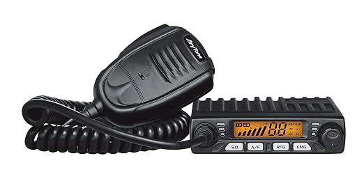

I've been looking for a small / powerful CB that I can install without taking up a ton of room in my 4Runner.
This one should fit the bill
AnyTone Smart CB Mobile Radio/transceiver 10Meter with FM/AM mode, Frequency Range:28.000-29.695MHz Power output 8Watts FM/AM Radios Mobile Transceiver
http://www.amazon.com/AnyTone-Mobile-transceiver-10Meter-Frequency/dp/B0140QP3VU
Yes it's listed as a 10 meter radio, but with a simple mod you can open it up to over 400 hundred channels including 11 meter / CB band
(De-solder OP2 and solder OP1 to keep high power. Use band D for 11 Meter CB.)
Here's a YouTube review that really shows just how compact this radio is.
I just ordered one, and can give a review if there's any interest.

Got the little sucker all mounted. Fits in the Land Cruiser like it was made for it!
Matched it up with a 5 foot Firestik.
SWR is 1.3 -- not too shabby.
PWR is 8 watts (without the amp)
Was able to get a radio check on CH - 19 from a driver who was roughly 10-15 miles from me. Reported it sounds clear with a strong signal.
I'll post up some pictures later.
I give this little guy two thumbs up.
:peep:
Some good info here re: small CBs. I was looking into the Uniden 505 myself.
The 505 is a great radio also.
I've been using my AnyTone Smart CB since the 13th, and am very pleased with this small / powerful radio. It does take some time getting used to the controls being push button instead of a knob.
I also added a remote speaker since the radio was mounted in the dash -- works great!
