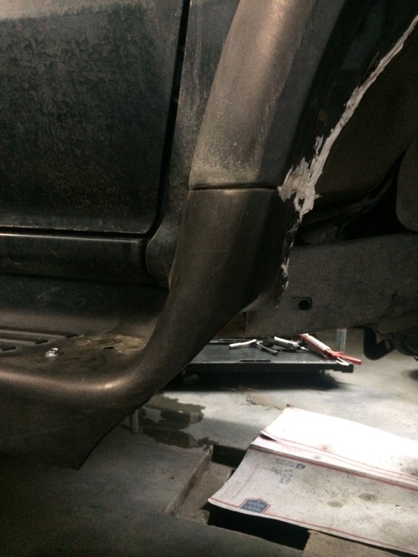

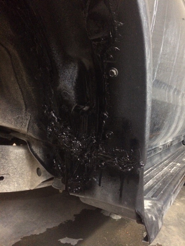

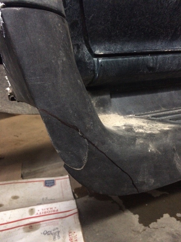

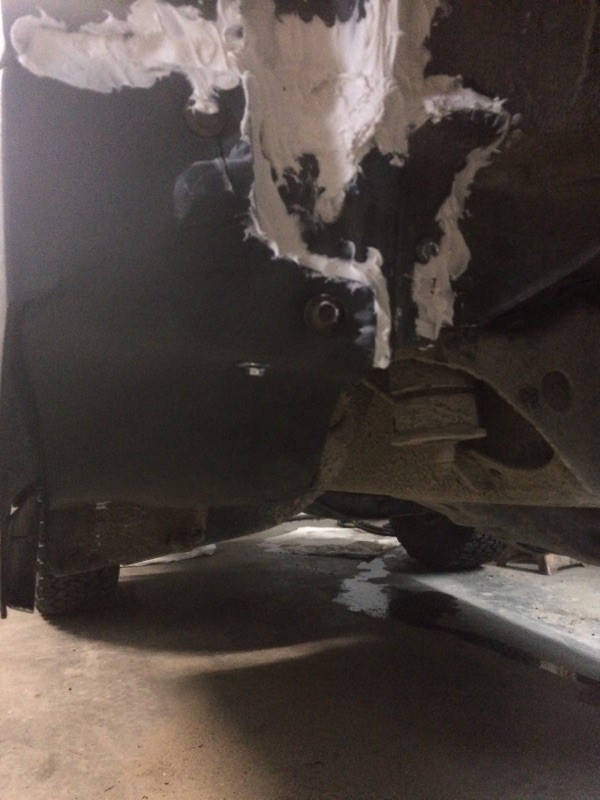

Jeez...realized I did not post up the last pics. I just cut the front of the running board end. Works and keeps mud off perfectly.

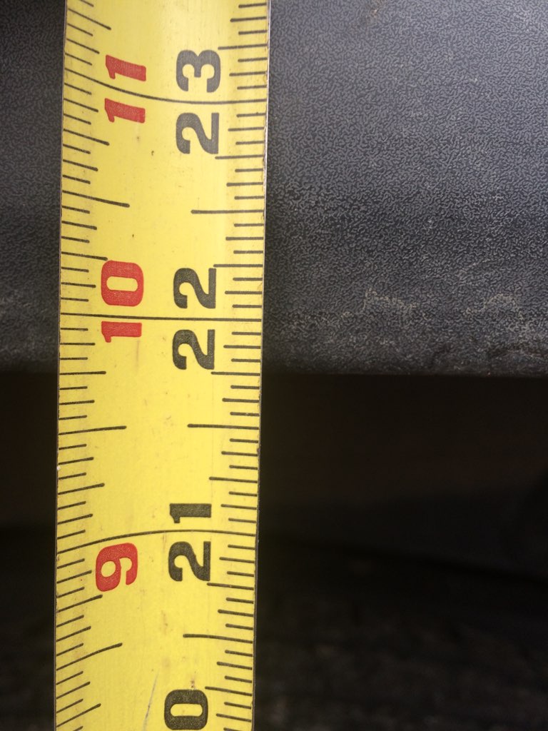

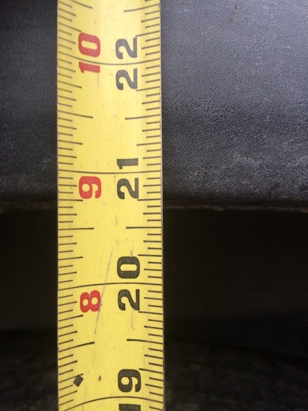

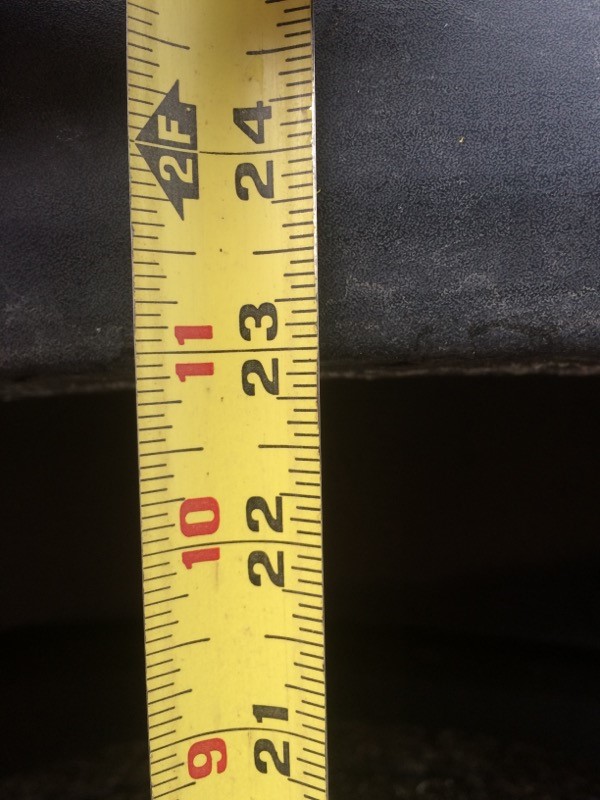

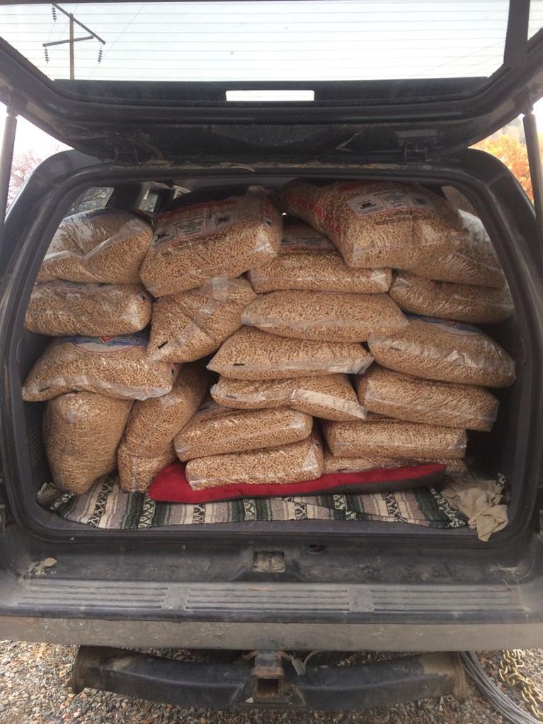

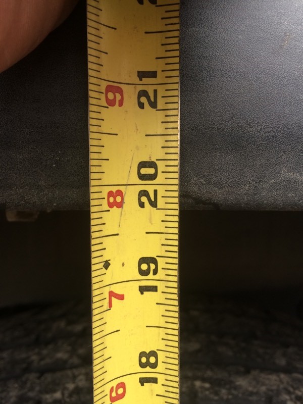

Ok...so a few K more miles and I threw some weight in it. Remember this is 906/5100 rear with NO AIR in bags and a 1" body lift. All measurements are on flat ground to center of hub. Total weight is 1K in 250lb increases...had a couple bags laying over back of rear seat to get them all in.
