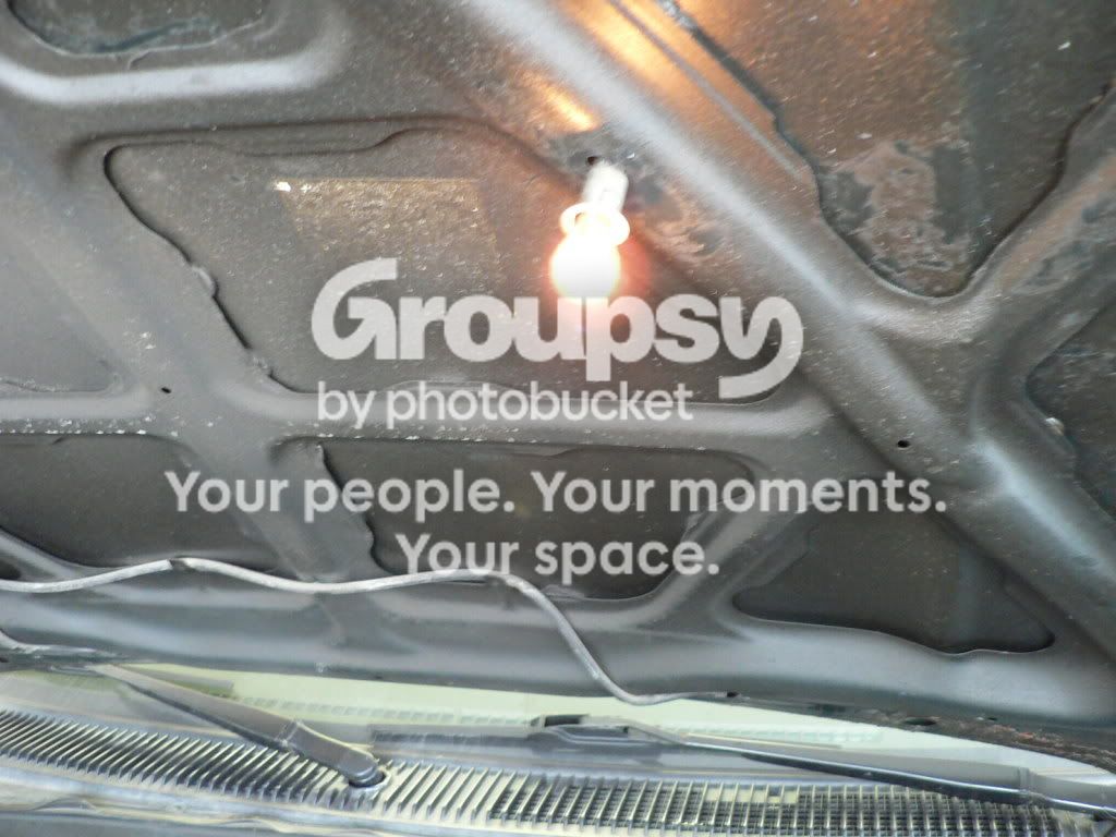

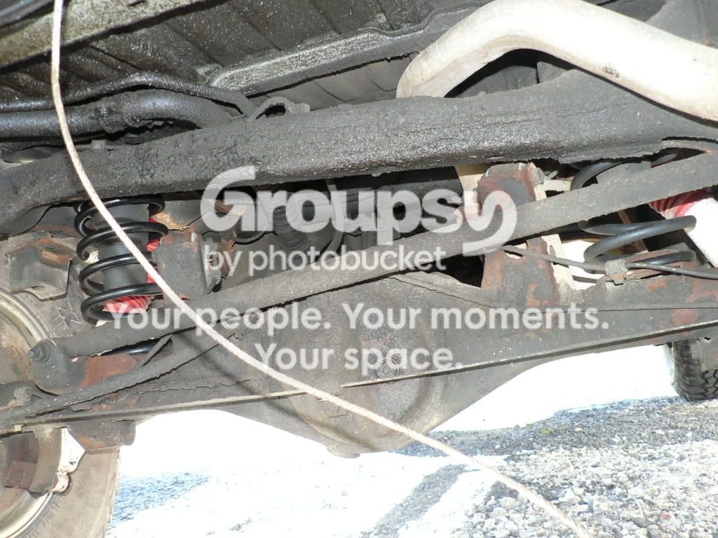

I coat my undercarriage with oil. It does not remove old rust, but it will stop it from getting worse.
Pics of my undercarriage after years of oil coating. The previous owner never treated the undercarriage, but began and continue to do it every year.
P1110581.jpg~original
P1090040.jpg~original
P1080413.jpg~original
Is it messy?? YES. Will it save your undercarriage from become a piece of Swiss Cheese?? YES. Do you have to do it every year?? NO (I did it regularly for the 1st couple of years, but now do it every second).
This is the most cost efficient way I have found to save my truck from certain death! lol!

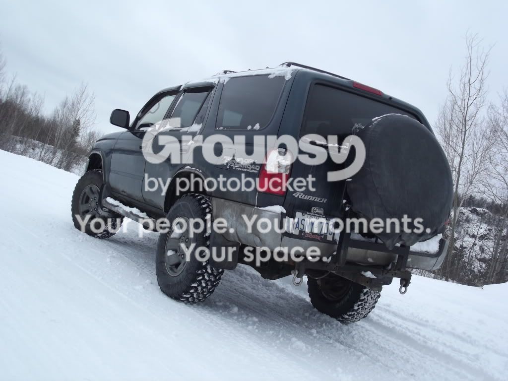

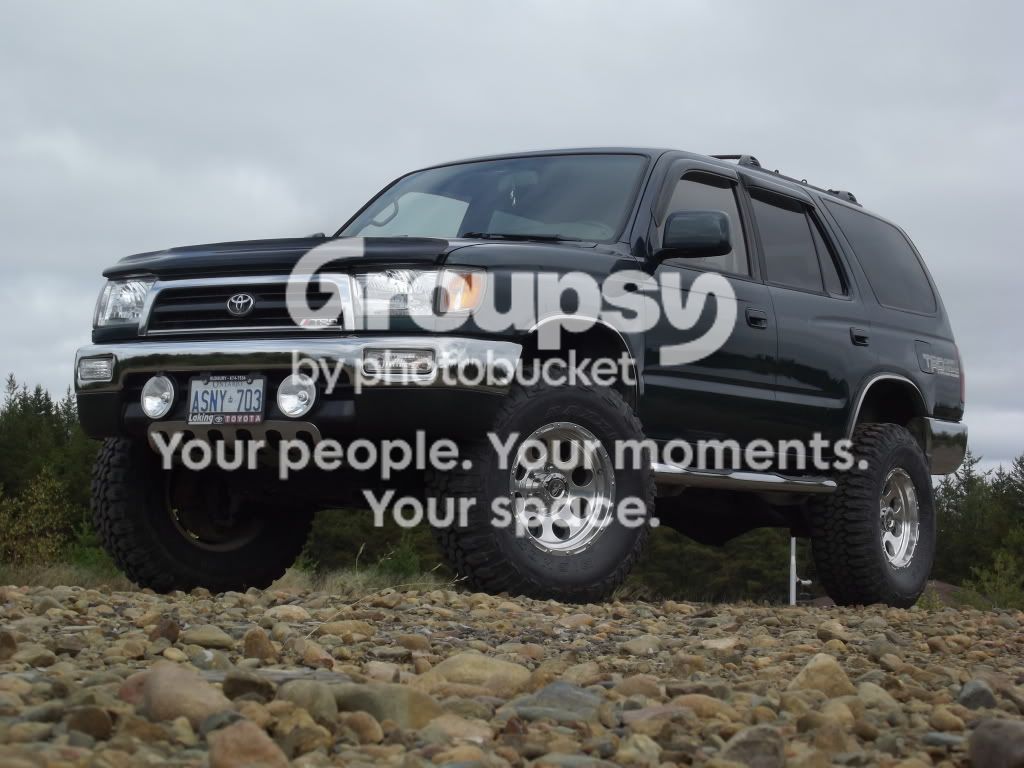

I also coat the chrome, rocker panels, and lower door edges with WD40 several times per winter:
DSCF6321.jpg~original
Looks bad in the winter....but looks like this in the summer:
DSCF5347.jpg~original
Not bad for a 14 year old truck in Northern Ontario Canada....
