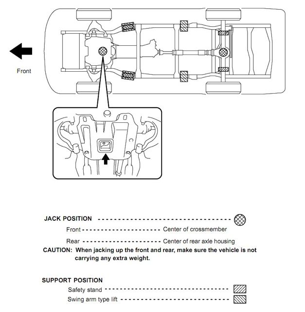

Yes, lift via rear diff housing and the front place denoted by the circle hole thing in the skid plate. Then put jack stands under the frame or rear axle.
