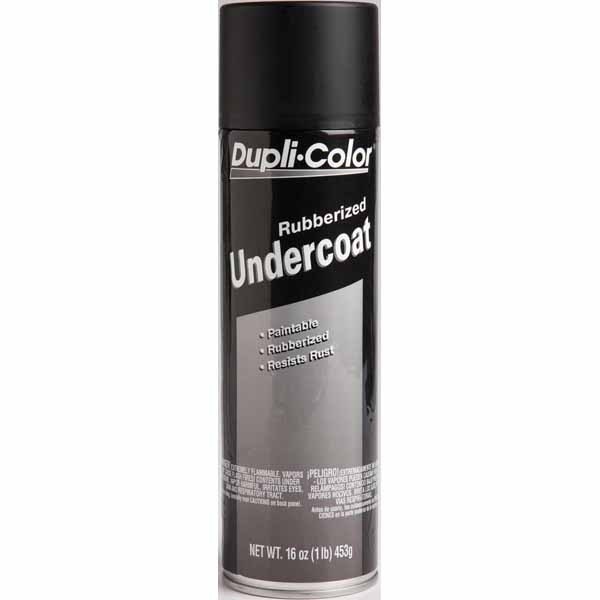

Chris - now that the harsh winter is slowing melting away I think I am going to do this to my 2006 SE this spring.
Just curious, how much prep did you do to the plate before spraying (clean, sand, etc.).
Any problems with it chipping or peeling?
Lastly, I see Duplicolor has rubberized undercoating. Is this the same stuff you used (pic below)?
looks good and I also appreciate the details!
I just scrubbed mine with a brush, water and Simple Green. I then used a hand held wire brush (similar to a grille brush) to knock off any loose stuff. I washed/rinsed again and let it dry in the sun. I then shot with Duplicolor truck bed liner. I have used the rubberized coating you have shown above. That's good stuff and should work ok. I think the truck bed liner resists oil that may be spilled during normal servicing better. http://www.duplicolor.com/products/truckbed.html
I have not had any adhesion issues.
