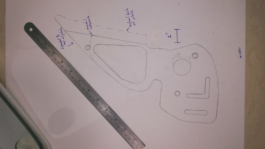

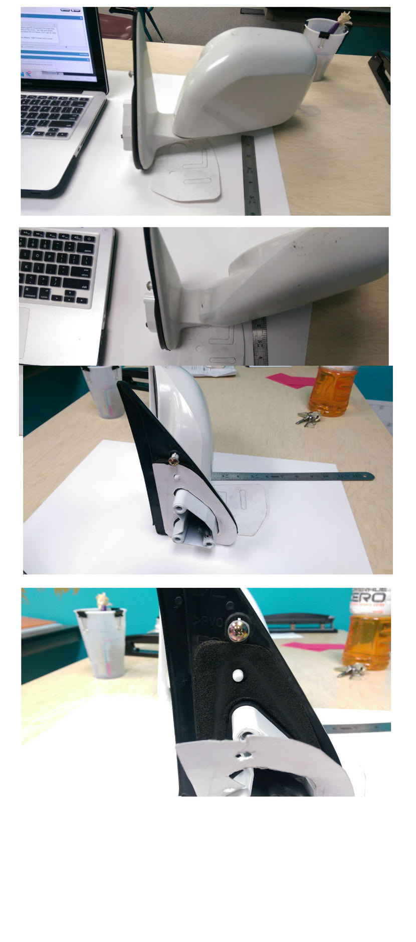

So I attached some photos of the template on the mirror, and I know this template is not FINAL, but it gives you a rough idea of how it mounts to the mirror and where modifications will need to be made. ANY input you have would be greatly appreciated.
If you look where the bracket attaches to the mirror, the solid metal housing where the bolts attach has a larger ring beneath it that may cause problems with the original design.

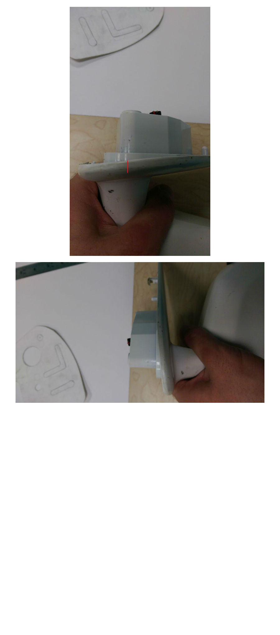

Troubleshooting
So here is a better picture of what I'm talking about. It looks like there is a gradual slope to the mirror plate, which I've marked with a red line in the picture. From that view, you can see where the second ring may cause some interference.

There is 7/8"- 1" of clearance between the bottom of the mirror and the top of the bracket, depending on where you mount it. The closer to the mirror mounting plate, the less room there is due to the sloping shape of the mirror bracket.
I suppose that the easiest route for the wires is directly under the plate. This may require some modification or crowding of the seal at the bottom of the mirror. You could use some silicon to seal around it.

I hope this helps. This is the retooled version that lays as flat as possible against the mirror. If I can just get one made, I can make corrections to the design as needed.
I know this will require some squaring of the bracket slots on the bottom plate.

Has anyone had success in turning the drawing into a CAD design yet? I'm thinking this may be a tougher route to go, but I may have another option/idea if this isn't working for others.
I noticed that at the bottom of the mirror there are three screws that hold the mirror to the bracket. How hard would it be to create a bracket that would fit in the holes and sit directly beneath the mirror while using slightly longer bolts/screws to hold the mirror in place?

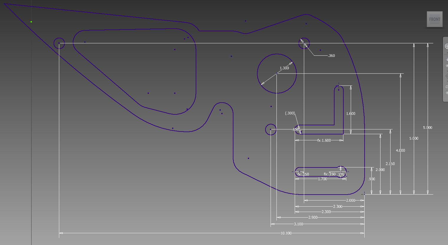

[MENTION=96630]jhuerta22[/MENTION] Do you have an email? Here's what you want. I though about making some of these a while ago, but didn't have a press brake. I made one for our shop press last weekend and seeing as you've done the leg work I will do you a favor and make your drawing into a dxf and pdf. Please print it out and compare it and make sure it works. Also I have dimensioned all the holes, if the dimensions are wrong change the numbers so it will be easy for me to just plug them in. I referenced everything to the bottom right hand corner, you can make these measurements using a ruler square or a caliper fairly accurately.

[MENTION=100116]D Farms[/MENTION] I just pm'd you. Much appreciated! The only thing I can think of on the design is the large hole in the bottom plate should be right at 1.25", but I'm sure I can make the corrections on that! Still, much appreciated!

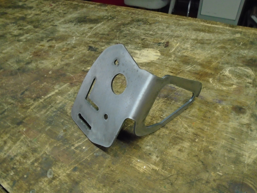

I made a test one last night, Im definitely going to redesign the mounting surface, its just a copy of the "yodateq" mounting plate and has way too many holes.

That looks amazing! Nice work on the bracket! The general idea behind the mounting plate was to mimic the yodateq design to give people opportunities to add different light setups and broaden the marketability of the bracket. Honestly if I were to have my own set I think I'd simplify it down to just holding the lights.
If end up selling some, of a slightly different design, they will be the same price as the yodateq ones, which is $129 including shipping.
