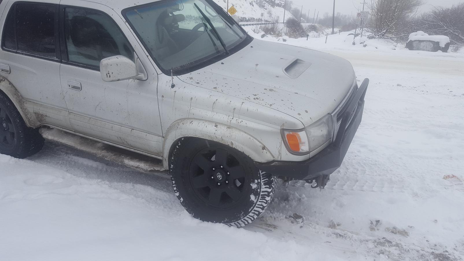

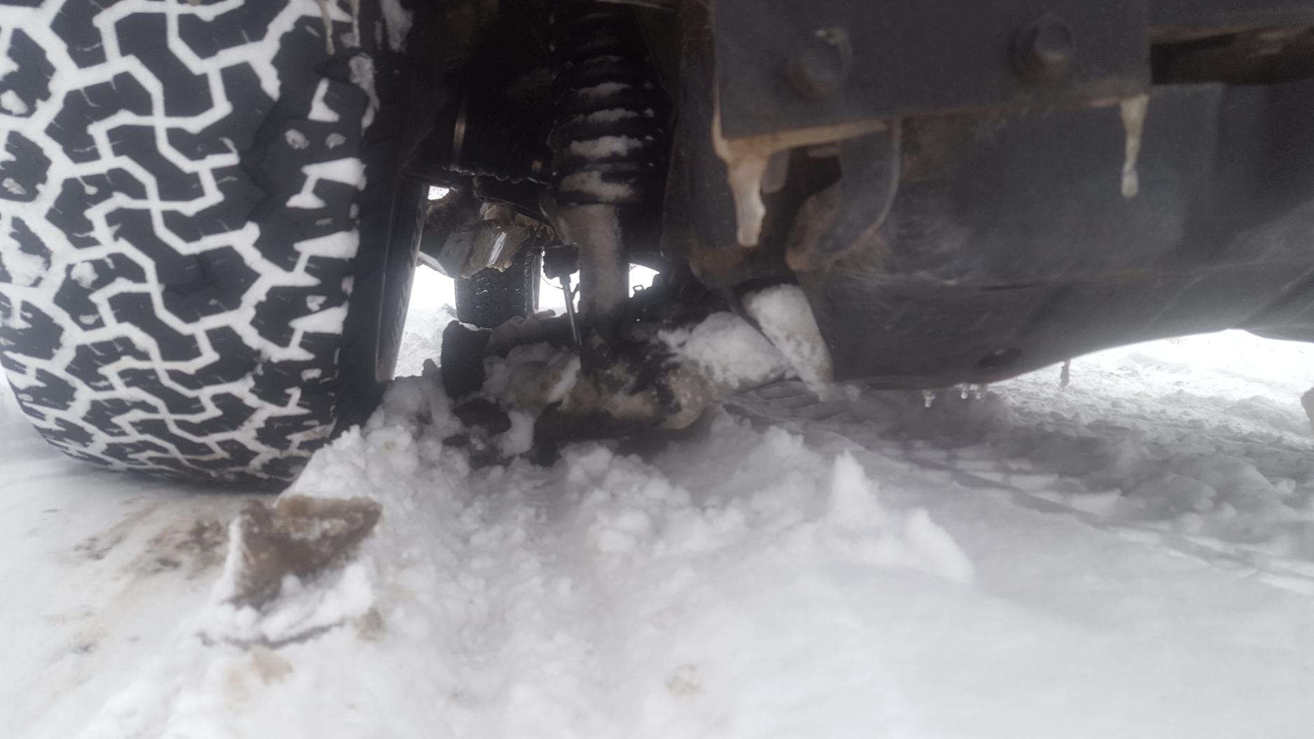

I can second that, i had the 2 inner bolts snapped because the 2 outer bolts worked there way out. It happended while i was in the parking lot. But for several days now i havent been able to get the 2 snapped bolts out. I added a couple pictures from the accident. Im just glad it didnt happen while i was cruzing on the freeway all day
