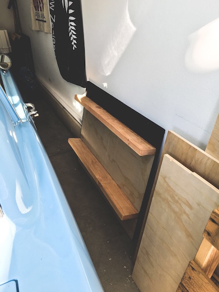

Can you post a pic of where/how the sleeping extension is stored when not in use?
Sure thing!
I'll snap a photo in the morning and post it up.
My garage is pretty trashed but its basically just a sheet of wood that rests in my garage.
Photo coming at ya in the morning though!
Just on the side of my garage.
Doesn't really take up too much space.
Laying like that, its about 30in tall and 41 in. wide.

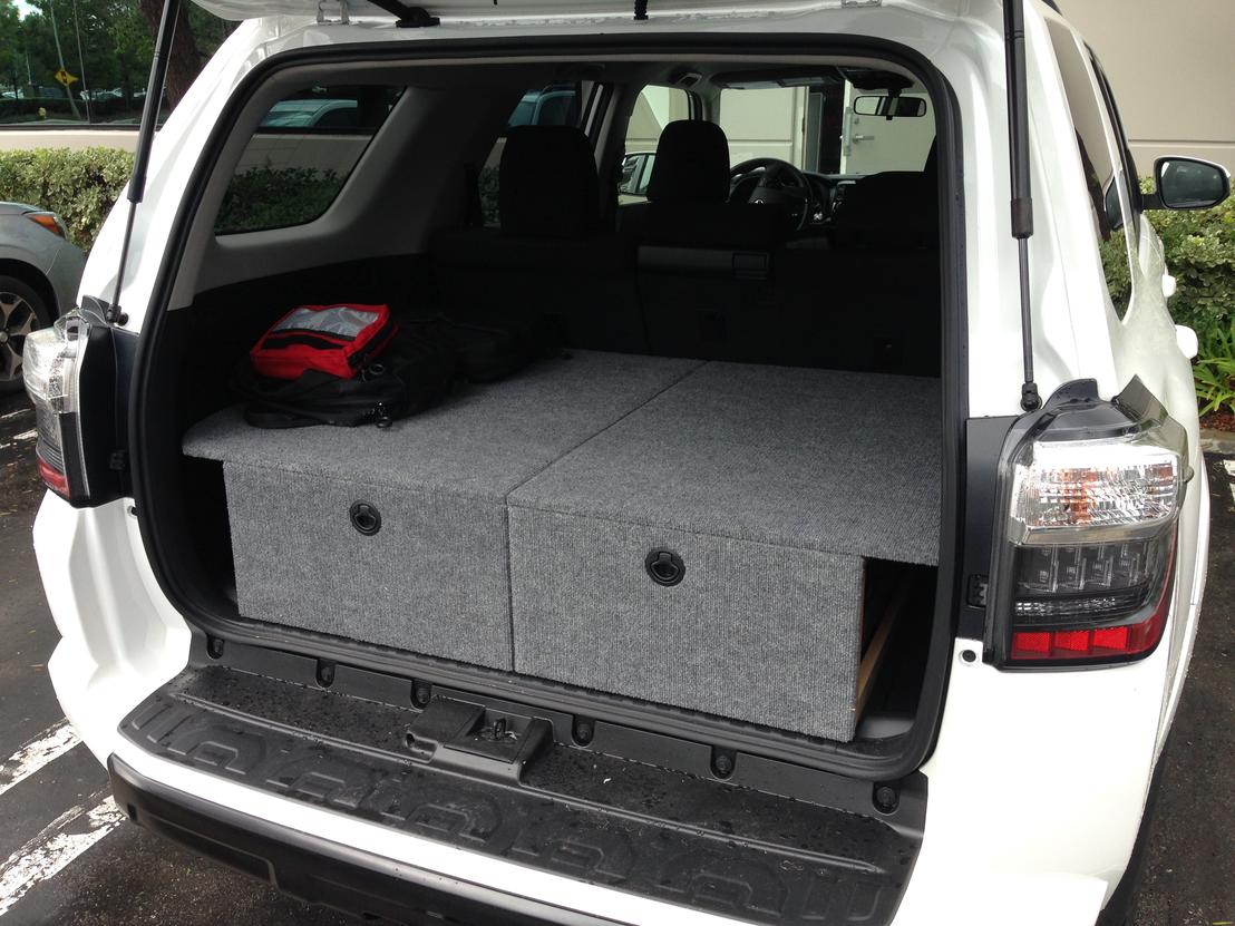

Looks good! Heres a link to the drawer system I built. I still need to finish the sleeping extension, been too lazy in the garage lately.
My whole objective was to keep it light. The frame itself is only 8lbs. Im not sure if my drawer construction is any lighter than just going with 1/2" plywood, its definitely more of a pain to do it my way and looking back on it I'd probably just do 1/2" plywood in the future. The 1/2" top is plenty strong resting on the wheel wells and frame.
