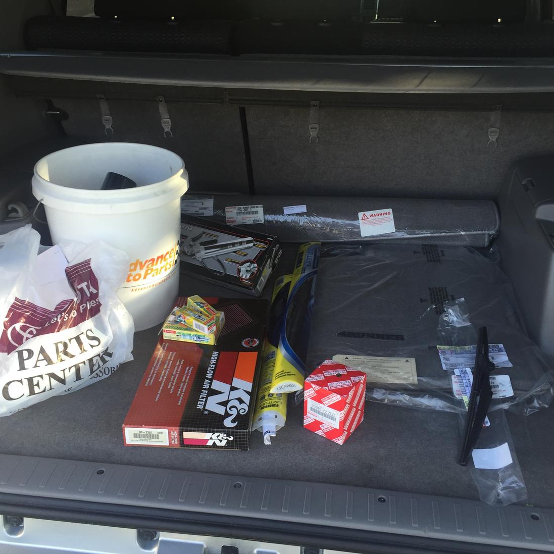

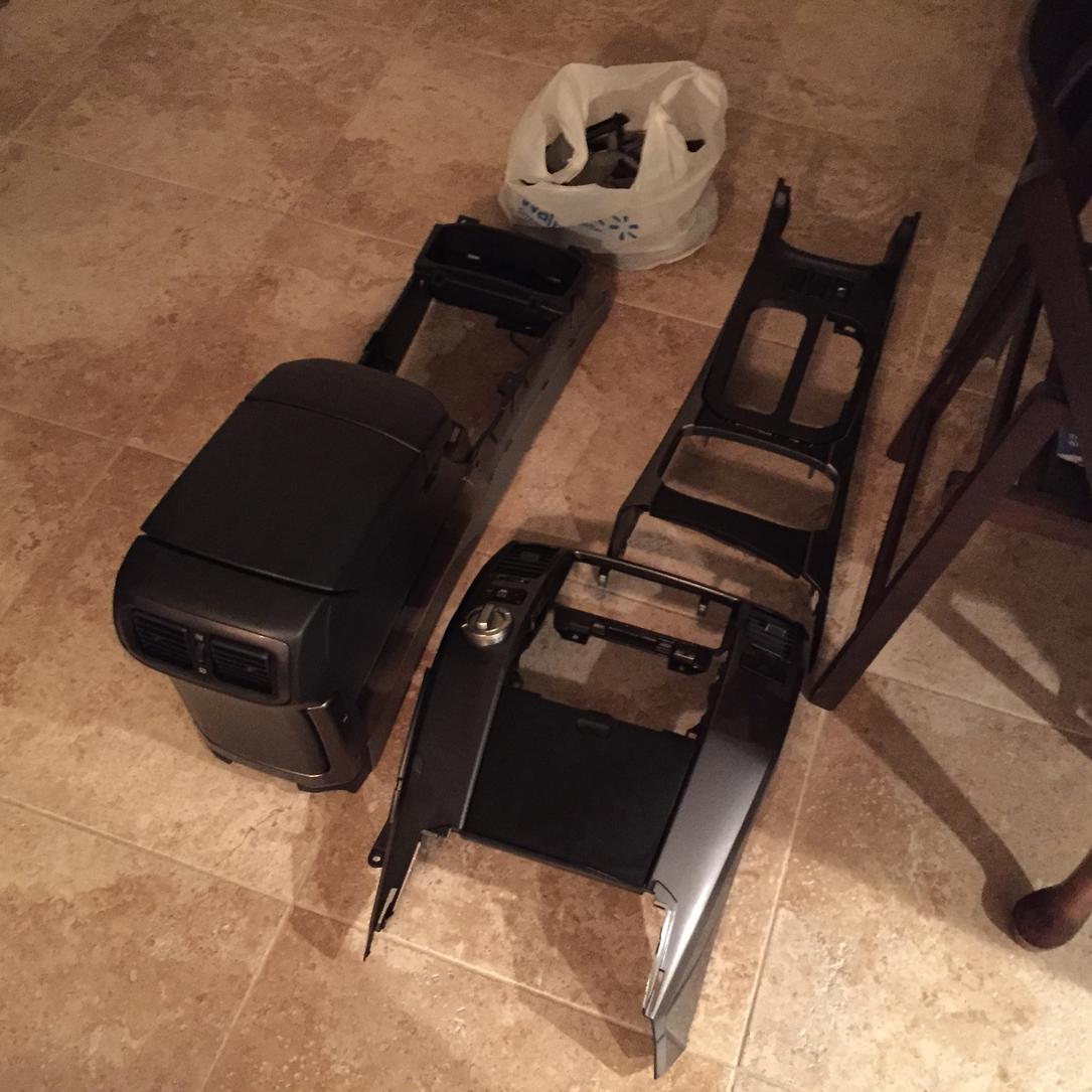

some pics of the goods, the horrible best buy install, and the plastic pieces all cleaned up..

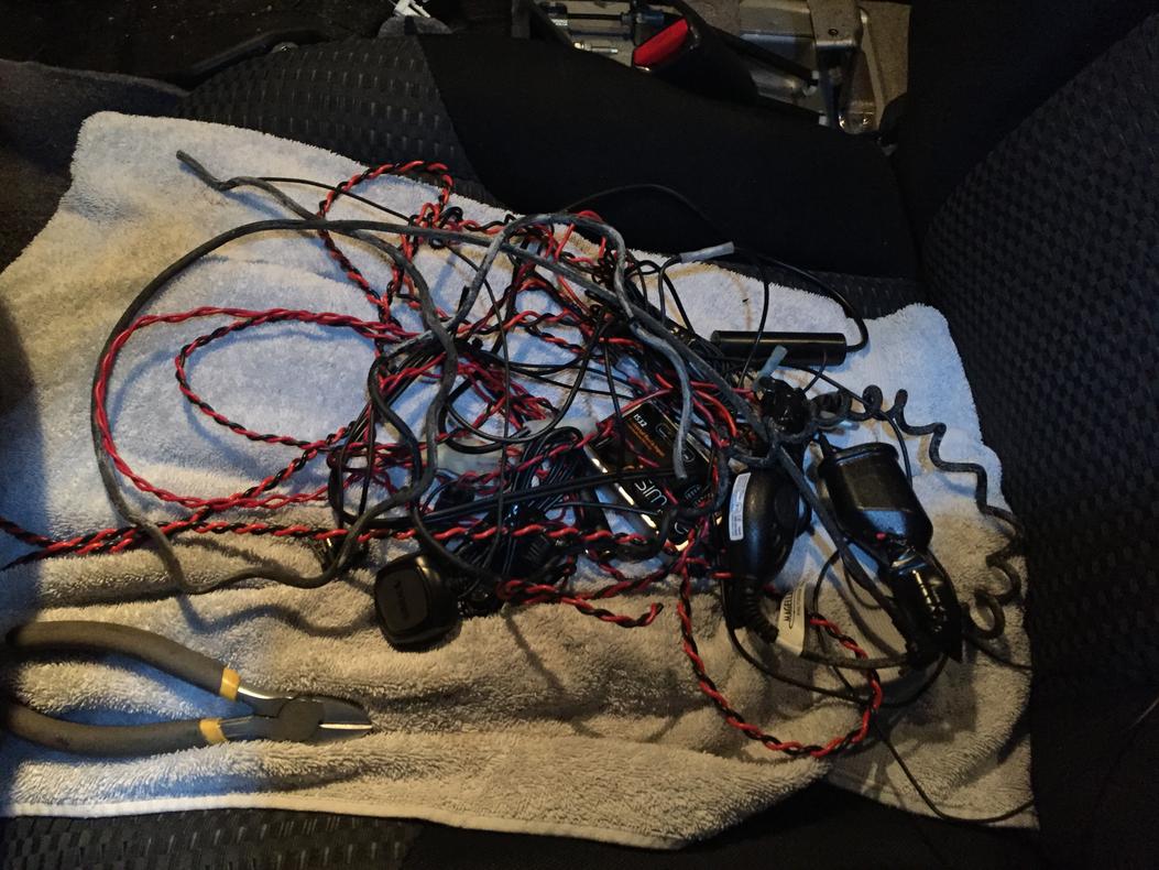

Hey man, knock this installer not the company.
When I worked for a Best Buy here on the east cost me and my coworker had a combined 18 years of experience in car audio and fabrication. We had some fly installs role out of that bay.
I do concede that Best Buy does hire some retards as installers though.
What's the part number and price on the rear hatch button you replaced. I have an 08 that has also turned to mush and needs replacing. Thanks
I feel you on that Sirius removal. The only way I figured out what was what was by finding different non OEM looking connectors and non oem electrical tape. Real PITA.
I had a buddy in college who worked there and he was a genius..
but i think they hired a high school kid.. From the screw driver marks on the dash from prying the front plastic piece to get to the headunit, to the 4 phone chargers he used as I'm assuming relays, i have no idea.. how you can put 4 phone chargers behind someones dash and then charge them for your work is beyond me..
Yea that's embarrassing, I'm sorry

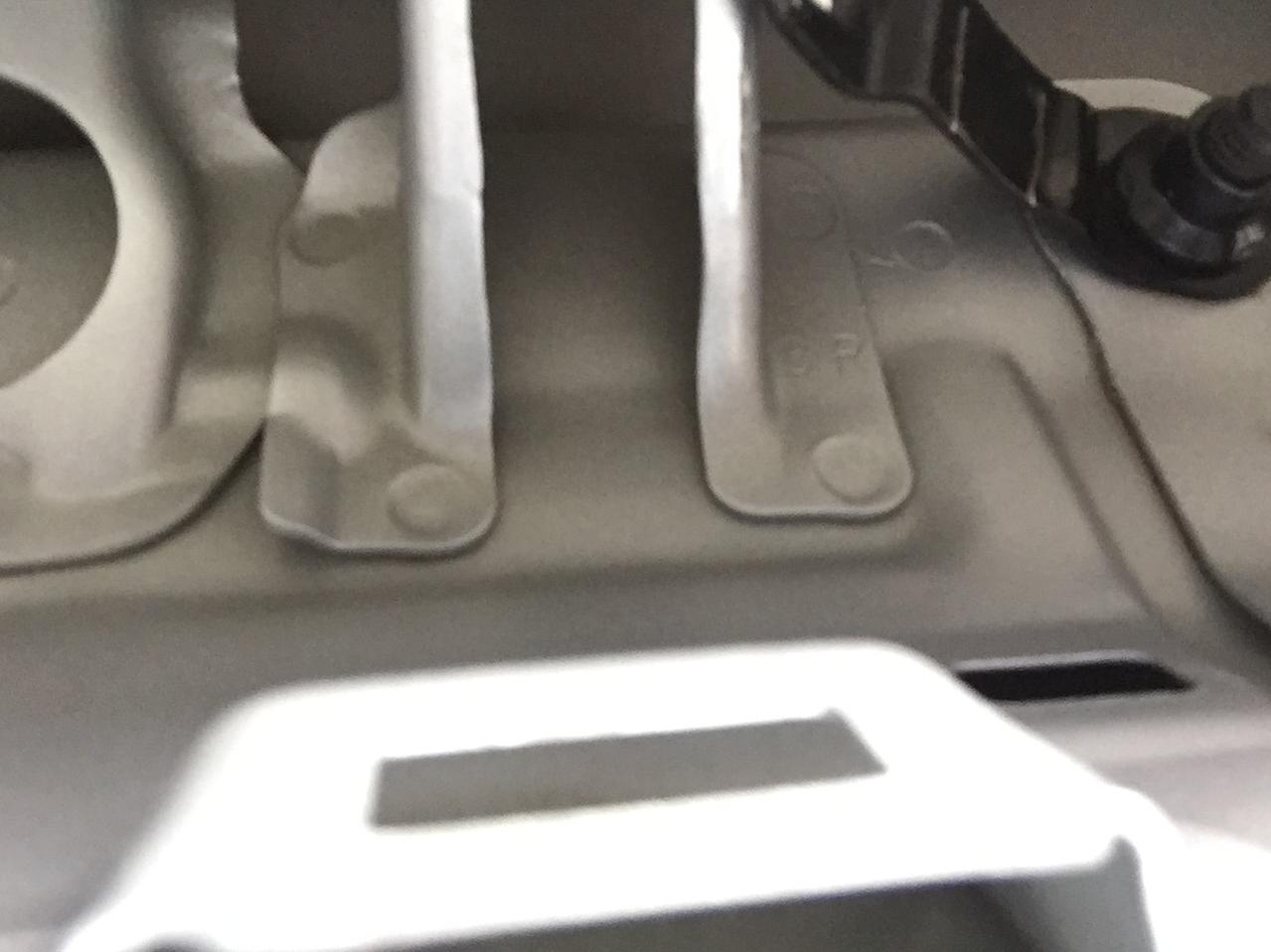

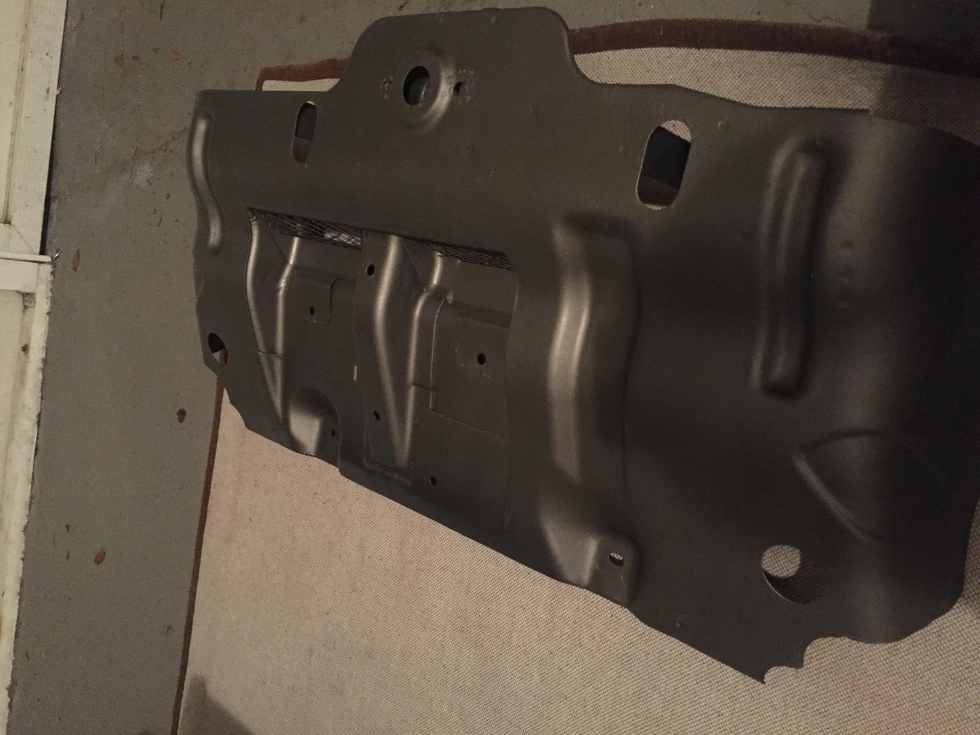

3. I sprayed the frame with VHT Chassis Paint (flat black) and sprayed the skid plates... Looks much better..

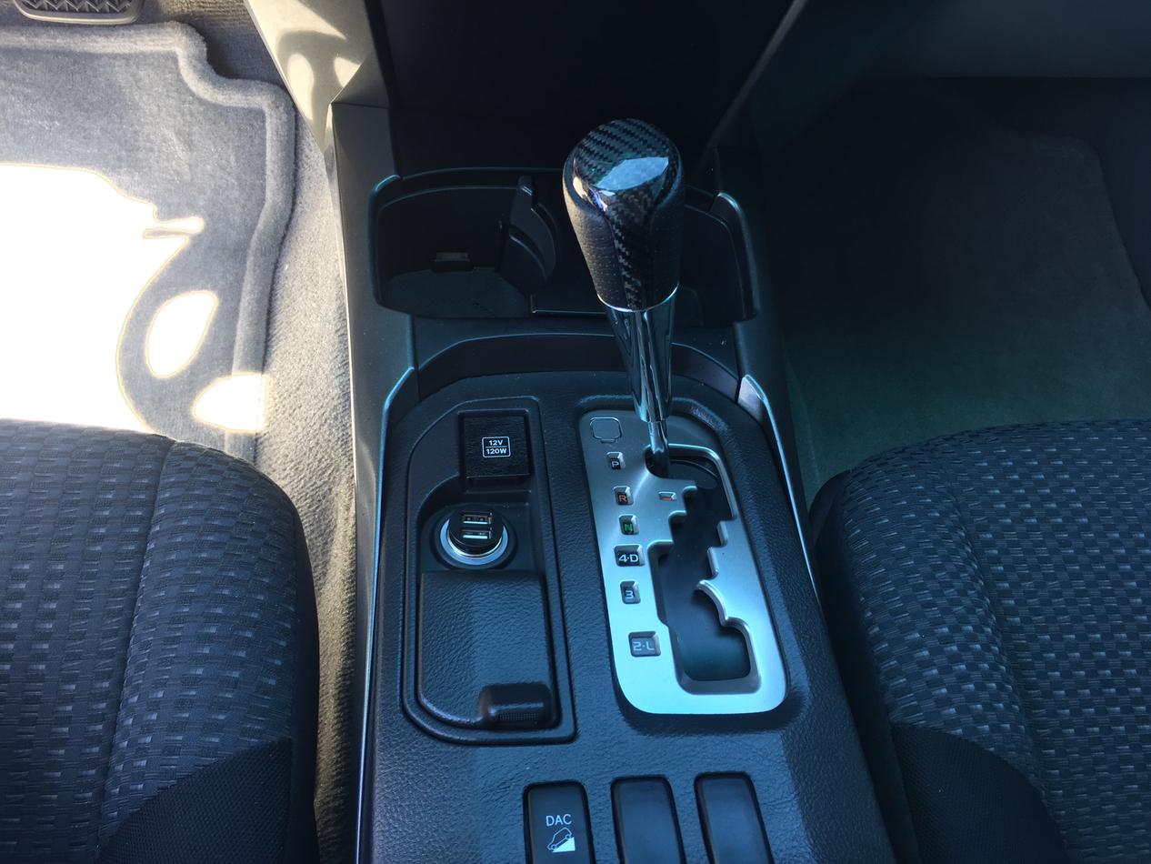

5. purchased the ashtrey 22 bucks and then a carbon fiber shift knob.. 24 bucks.. love it..

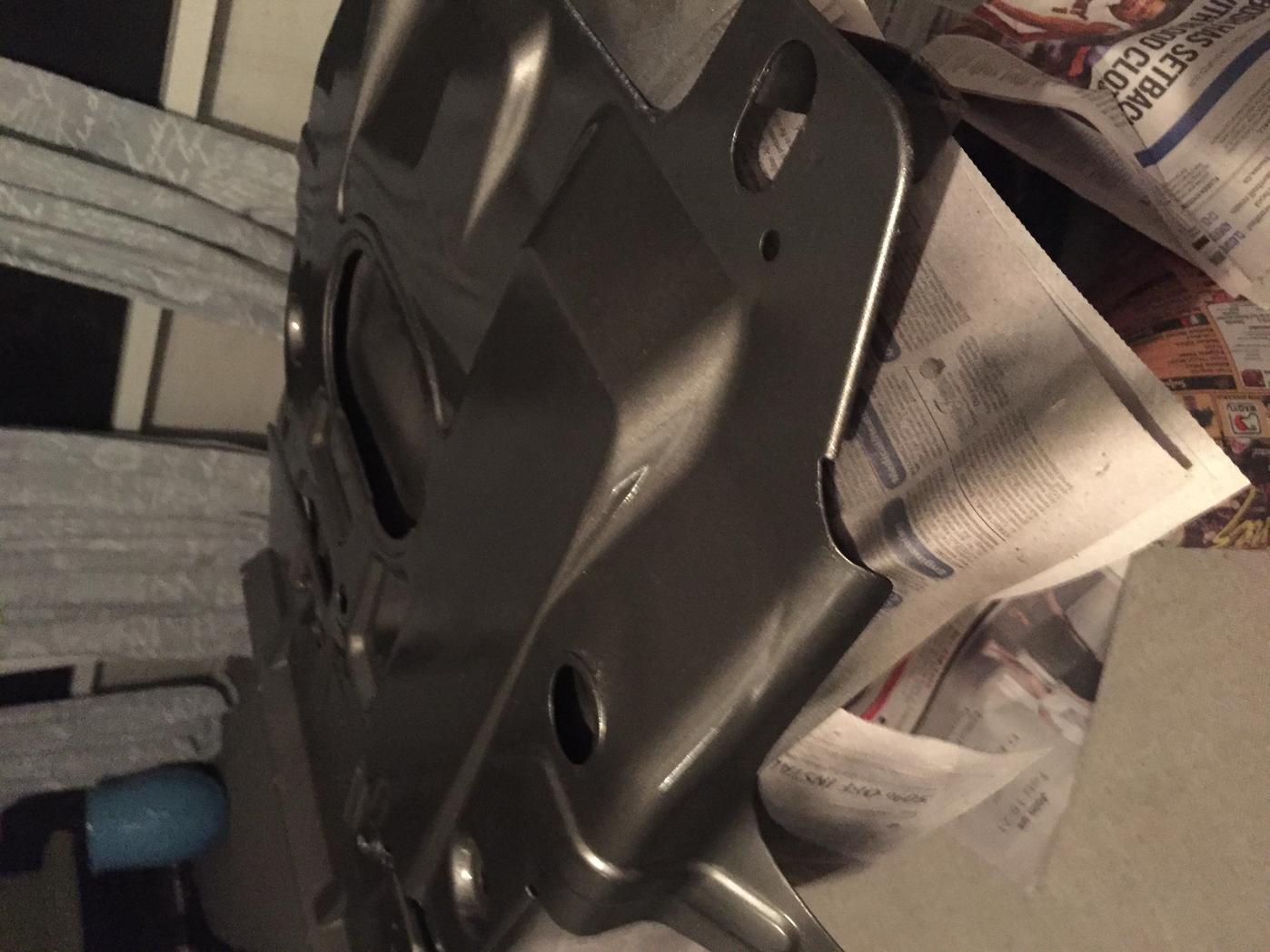

added some carbon fiber wrap.. dont know if I went too far.. what do you guys think...

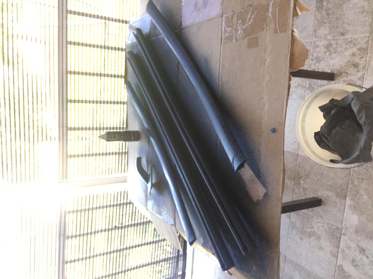

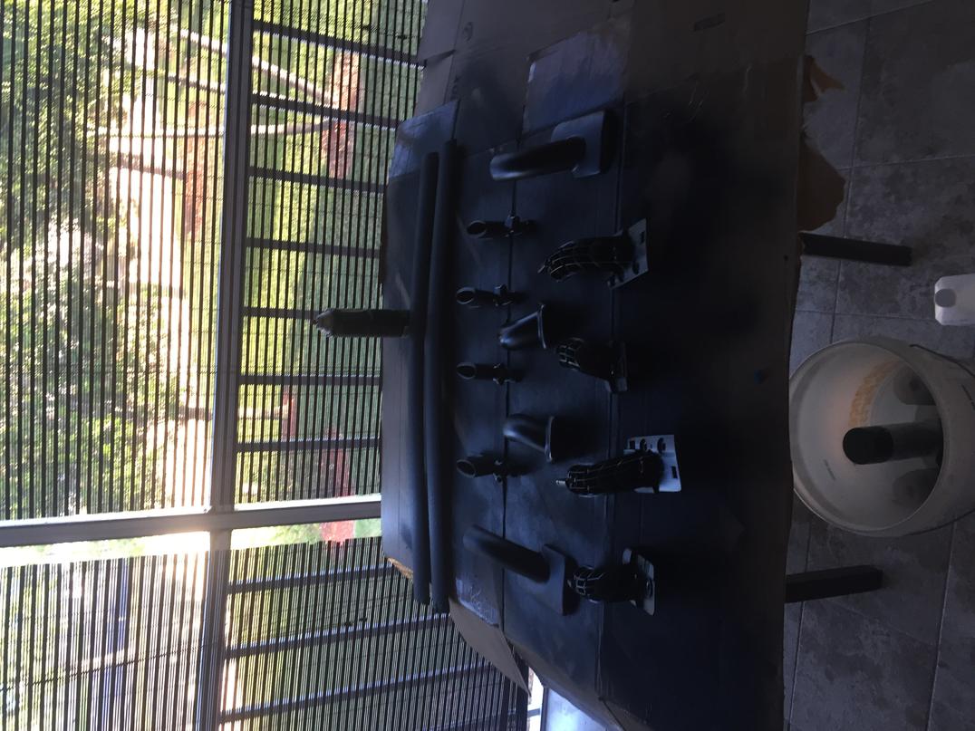

sprayed the steps and roof rack with Duplicolor bed liner spray... and the components in a standard black trim spray paint, with a flat clear coat..
turned into a pain in the ass to be honest..
-when taking the roof rack off, prying the covers off was very simple.. the two star bolts holding it down became an issue though.. I only ****ed up one in the back, trying to untorque them, the 2 bolts have a connecting piece with two nut inside the frame (top right pic below).. so loosen them up in a pair.. i took one out and tried to un torque the other one and it snapped off the clamp, then bent the clamp and the bolt was spinning around.. had to take off a lot of interior trim to get to that piece in the back.. I bent it backed, and eventually got the last corner off the car.. lesson learned...
- painting was pretty straight forward but time consuming..
- I am wondering if I should of just used regular black paint on the tubes instead of bedliner.. the tubes naturally have a sandpaper like finish.. but we will see, this stuff has rubber in it.. I was hoping for something more durable but this they say is...
