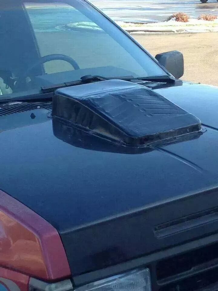

I personally like the dollar store hood mod.
