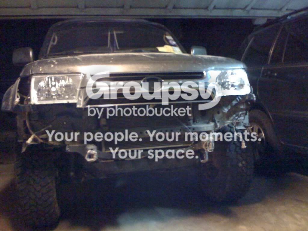

wow thanks a lot man. the only problem is my plates got kinda messed up in my wreck heres what they look like
ce6c148c.jpg~original
could i just cut off right after the part thats like kinda smashed to the side (look at the left rail to see what i mean). or is the frame plate the whole little section thats about a 3 inch block on the end of the frame?
Was some of the frame extension removed? If I remember correctly there was a lot more frame for the bracket to slide onto, your's looks nubbed
I think they look nubbed too. They might still be long enough to suffice though, it looks like you have enough of a lip still and the mounts bolt on using the holes for your tow hooks which don't seem to be bothered by the damage. You'll have to grind all that smash flat because the mounts are a tight fit when you slide them on. Looks like it'll work though without too much extra effort.
