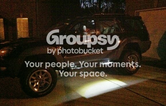

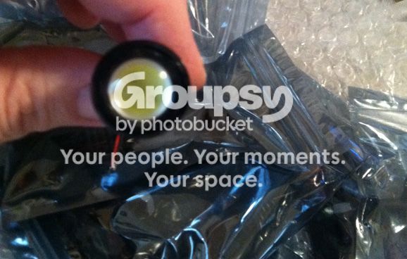

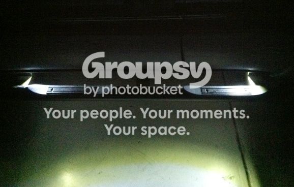

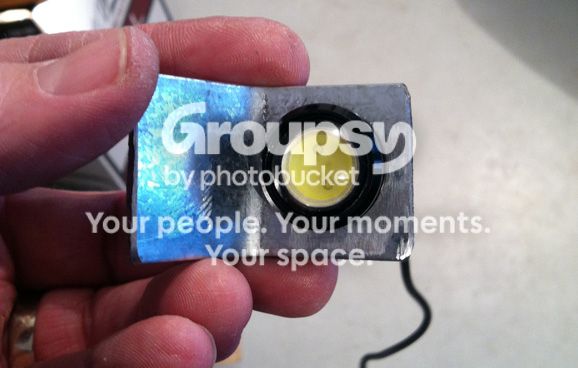

Ever since i removed my lighted running boards and replaced them with the step tubes, I (as well as my wife and kids) have missed having lights on the steps. I was glad to find these Eagle Eye LED lights on ebay, for around $4 a pair shipped. These are 3w lights, which doesn't sound like much but they put out plenty of light. I originally wanted to mount one in the rocker strip, under the doors. I would have liked to have one above each step pad but that panel is right up against the metal of the body. I decided to make some small brackets and mount them to the insides of the step tube mounts. They are far enough up under the body, where you can't see them and just at the right height to cast light on the step pads. I had clipped the wires from my running boards, so all i had to do was tie them into those. They come on when i unlock and open the doors. I am very happy with these as well.
Tiny lights

Brackets made out of galvanized metal strips.

The perfect amount of light

I like the upgraded lighting, momo! Those reverse lights look brilliantly bright - even if the picture doesn't do it justice... I like the lighted steps, I wouldn't mind having some light, considering how many dark places I park... It's cool because it's not on all the time (like ricey cars with the neon lights underneath) but on when you need it, them coming on with the unlock thing is awesome!
Nice work!
Thanks man. I am more into the stealthy look so I was very pleased with the step lights. You can't see them at all until they come on. The tail lights were kind of an afterthought. I am extremely pleased with those as well. Can't wait to get my 30" light bar mounted behind the lower grill and my extra reverse lights wired up, as well as my secret project....:rofl:
