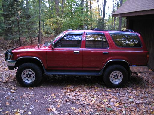

Moog coils looking pretty bad on a minor incline. In general these coils help with apperance, but catch them at the wrong angle and it's all back to sagg factory

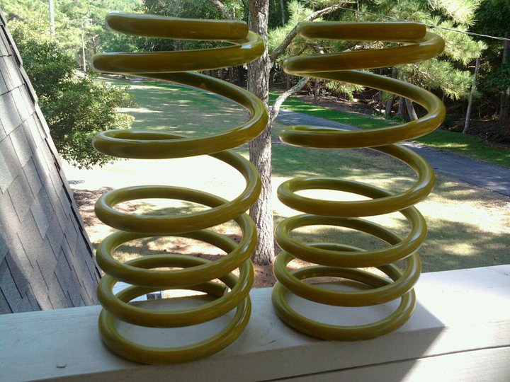

My 93 4Runner has this saggy rear problem, while I use this a daily driver of sorts I am finally giving these coils some much needed attention. Picked up these Moog CC255 from Amazon for $60 shipped with Prime. They came coiled around each other in the box and messed up some of the black poly coating. I just so happened to have a can of yellow spray paint and decided to give them a make over.
photo.php
I currently have a about a 3" difference from the front and the rear so these "should" level me out. More so then the Red Runner above I hope.

Success! Installed these bad boys yesterday, took a little over an hour. Mainly because we were also watching Alabama lose, LOL. My friend's TV and beer fridge in the garage is an awesome combo.
Rented a pain in the ass strut compressor set from AutoZone for a fully refundable $53 (its all they had). Took chunks of the fancy yellow paint off but whatevs.
Basically just jacked the truck up, took the wheel off, detached the bottom of the shock and adjusted the compressors to fit the best way. Didn't want to take to much apart so the compressors weren't on both sides of the spring equally, maybe like thirds. Made it a ***** but got it done. Only real tip I have is to watch out for the brake lines on the axle, the center bolt from the compressors put some nicks in it but with out paying attention we could have pinched it.
There is a noticeable difference in leveling, but I think it still looks about an inch or so short of where it should be. Handling wise, a few gains. High speed turns feel tighter and the nose doesn't dive nearly as much as it did at fast stops. I'd say this was an over all win and worth it.
1st photo is before.
2nd photo is just a side by side comparison of the Moog and Factory. Factory was lighter in weight as well as shorter like most have said.
3rd photo is after. Didn't get out quite as early as I wanted and missed the good sun angle, but I think it shows an improvement although not perfect.
I hope this helps some of you with this saggy rear problem make some decisions. Thanks for reading and let me know what you think!
