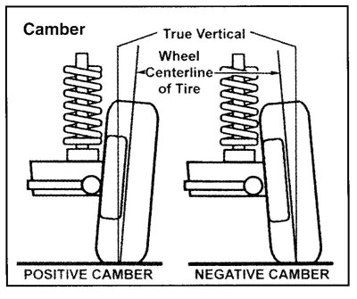

Thanks for you reaponse. Haven said that , what tire size do you recommed or are you using? Do you use camber +4 too? Thanks again
Caster near 4 degree. Camber should be very close to 0.
