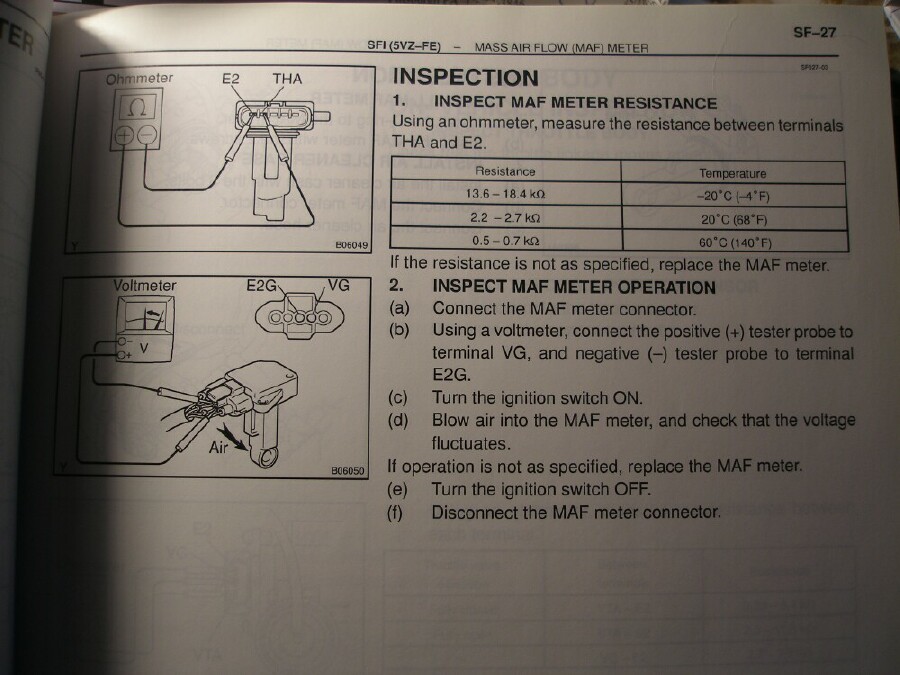

Hi guys, I wanted your expert opinions, I measured the resistance @ 4 Degrees Celsius and got 4.0 kOhms of resistance. This seems to be within spec? What do you guys think? I have the P0171 code but cleaned the MAF really well and cleared the code, still runs like crap for the first 10 minutes, then runs ok, then the check engine light comes back on.
I don't see how you figured that was in spec. Did you just figure out a ratio between temp and resistance? I would make certain that the ambient temperature is as close to the listed temperature as possible and test again. Did you rule out other causes of the P0171?
I'm not sure what else could result in that code. Everything I've found points to the MAF. I'd love to know what else to troubleshoot.
You're correct that I assumed it was within spec as it read between the 20 degree and -20 degree specs, I guess I could wait a month until it's -20 here in Toronto. Hehe.
FIXED! I took the Maf out and brought it inside. Checked the resistance, within spec for 20 Degrees Celcius. Checked the voltage and it fluctuates. The symptoms were so similar to so many MAF related posts that I took a closer look at the MAF I cleaned last week. Inside the tube are what look like two small resistors. They were really dirty. The How to I found online only talks about cleaning the air flow hole, and the wires. I stood the MAF up an UNLOADED a ton of carb cleaner into the thing. Did this about 4 times. The first 2 times the carb cleaner ran out black.
