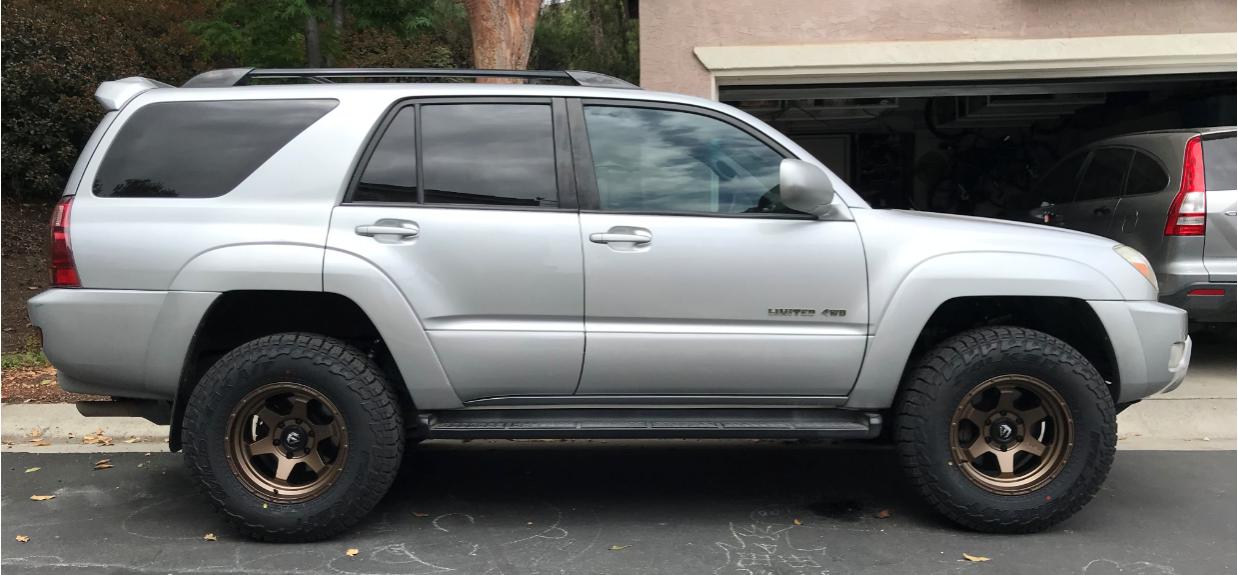

Hi and I had the same issue as you and have an 05 limited V8. I think you may have the Bilstein E4-FD1-Z005B50 (600 lb rated Bilstein, # on the spring). I just removed those last weekend and had them at the highest 6 clip. This is the spring that came with my 6112 combo kit.
I read many threads and with same issue and bought the Bilstein 52-291387 (E4-FD1-Z562800 on the spring, 650 lb per Bilstein). Supposedly it is for the V8 or additional weight on Front. It raised it about 1/2" at clip 3 setting. Ride is a lot better even on broken pavement but I plan to put to clip 5 to raise another 1/2" since i'm not satisfied.
I haven't had a chance to take a photo yet but can try to for before and after. I'm running 275/70/17.

Thank you for the reply!
Now that you mention it, I remember reading in the installation guide for the kit itself something about the V8 being heavier so the lift height would be different from a V6. Once I read that it seemed obvious but I already had the kit so I just installed it anyway...and here we are.
I'll be looking into getting new coils other than spacers. I might get some Dobinsons just to match the rear unless they don't make some that will fit around the shock itself. Something I'll have to email them about.
My ride quality is fantastic also. It had blown out XREAS before so it was very soggy and now its tight but still soft when it needs to be. Especially on bumpy roads. Just goes right through washboards.
Love the look of your 4Runner, by the way. Those wheels are amazing. The gold really works for your paint.
Cheers.

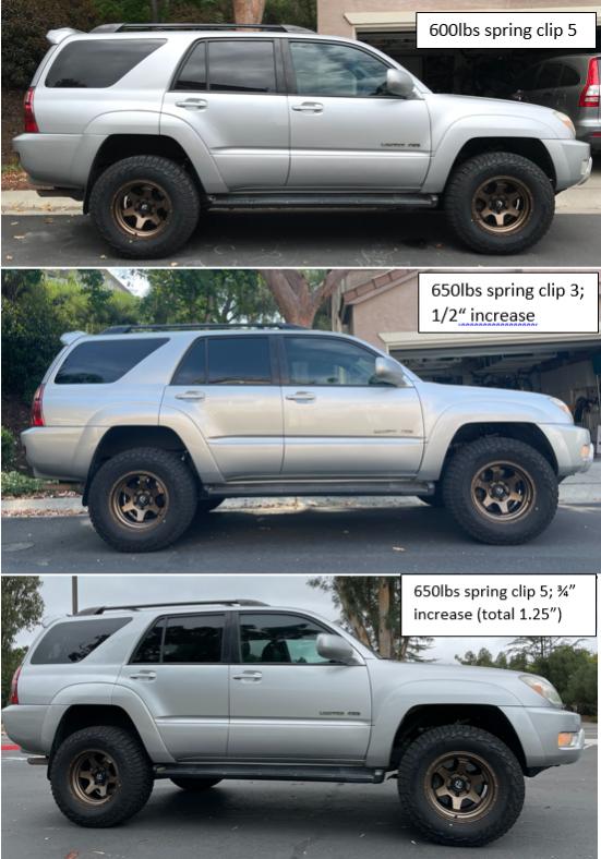

Get the heavier 650lb spring from Bilstein. I’m on clip 3 with a 1/4” driver spacer and it’s got just about 1/4” of rake. Rears are 5160s with Icon 2” spring.
Finally finished my setup at Clip 5 but still minor rubbing. Need alignment and adjust caster and hopefully it goes away. Overall with the 650lbs Bilstein springs, the lift was 1.25" from the 600lbs springs. Attached are the photos. Ride is more stiff but more controlled. I think Bilstein doesn't have the correct spring for the 6112 kit I purchased.
Mike
Sorry for the late reply I've been on TDY but wow this is great thank you for the pictures. Looks like springs are exactly what I need to get the height right. That looks absolutely perfect. I couldn't find the springs on Amazon but it looks like my local 4 Wheel Parts actually has them in stock ($166 according to their site; Link)which is even better. I will probably stick with Bilstein and skip on the Dobinson springs since I can't seem to find proof that they're a viable option. I'm sure they are perfectly fine but it seems safer to just put a Bilstein coil on a Bilstein shock.

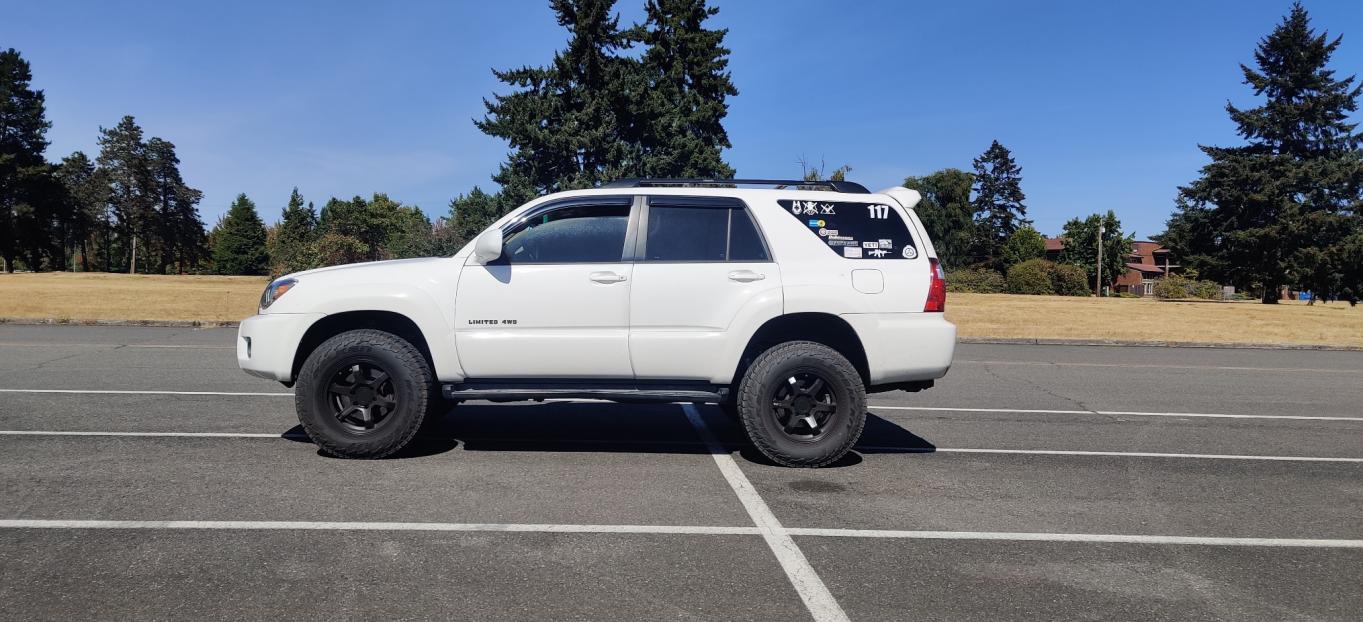

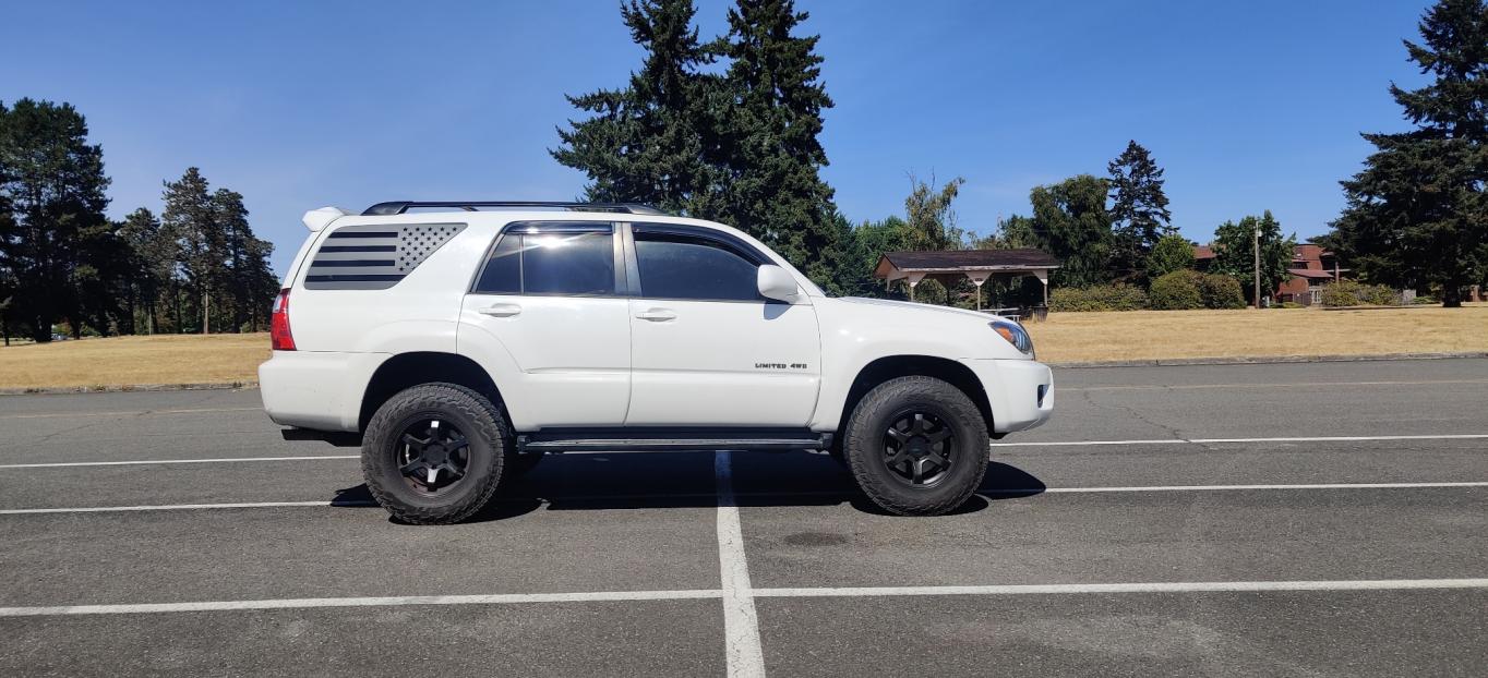

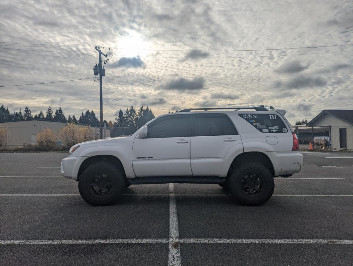

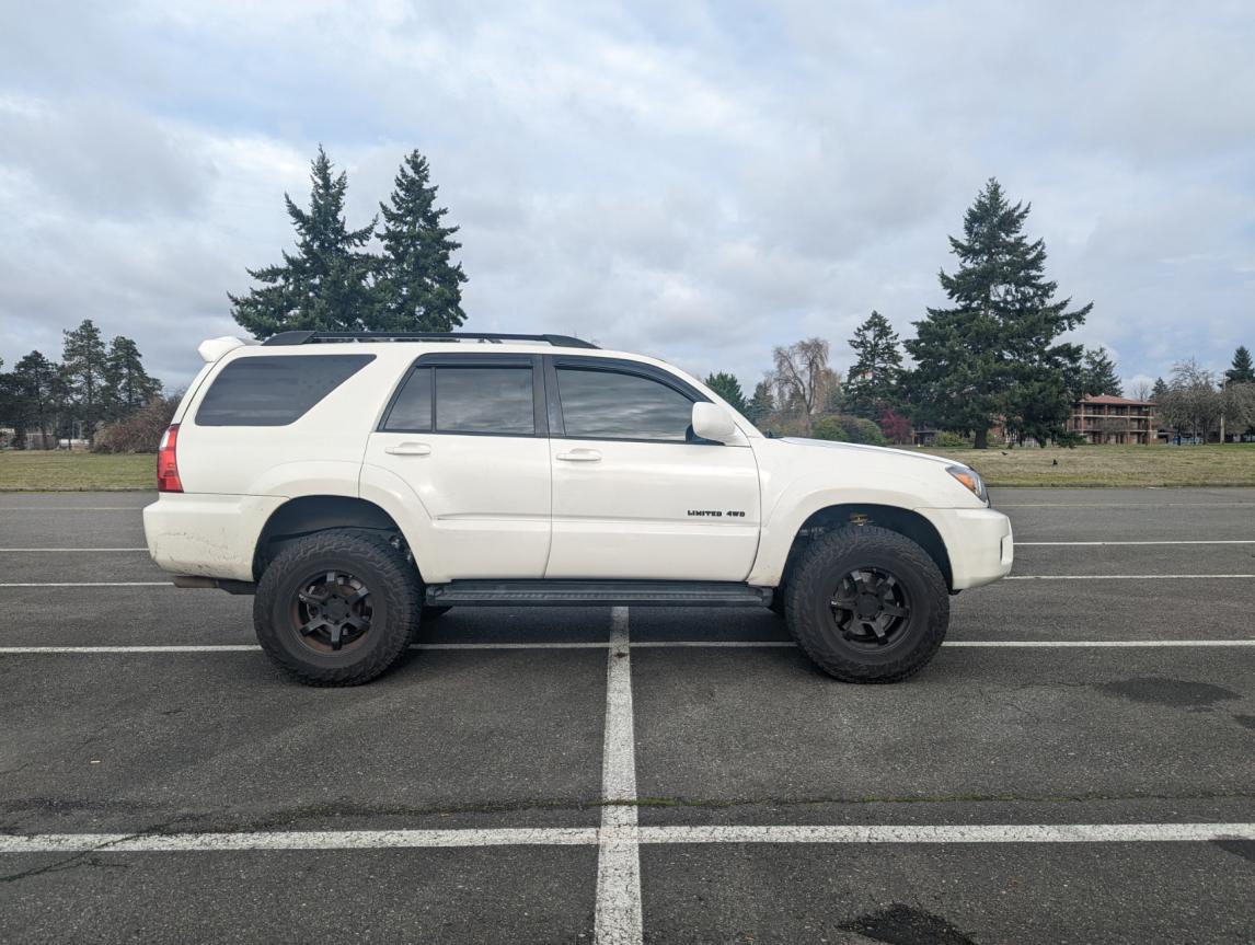

UPDATE on front spring install
Well it's been a little while since I've been on here. Lots of holidays and just busy overall. Not sure if anyone will see this but I said I'd update so here it is.
I had the new springs installed on 27 Oct so a little time has passed. Initially, it was a noticeable lift and it was even almost level. But nothing like I was expecting based on what I've seen from the other posts in this thread. Now, 2 months later, it seems it has "settled" and the significant rake has returned(see pictures; sorry about lighting. Can't get a clear day in Washington this time of year). Although, when compared to my original photos(first post), it is still higher up front but just barely.
I checked to make sure the shop (4 Wheel Parts) didn't move the ring for the 6112's and they didn't. It's still on highest setting(6th "groove").
So now I'm not sure how to proceed. I feel like springs are the best way to properly lift it but it would be infinitely easier to just slap some lift spacers on it.
