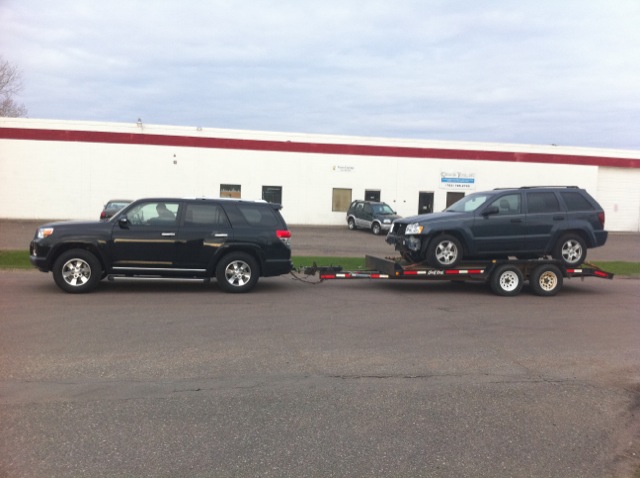

I towed over 5000 pounds without any problems for about 100 miles. Braking was not so good (no trailer brakes) and a little slow on the hills but otherwise i was surprised on how well the truck performed. Averaged about 15 mpg.

I towed over 5000 pounds without any problems for about 100 miles.....
You didn't have any problems because you were lucky and noone pulled out in front of you, or a dozen other things. "Over 5000#" with no trailer brakes is not very smart.... and, I should think, illegal as he!!.
I agree. Bad example.
