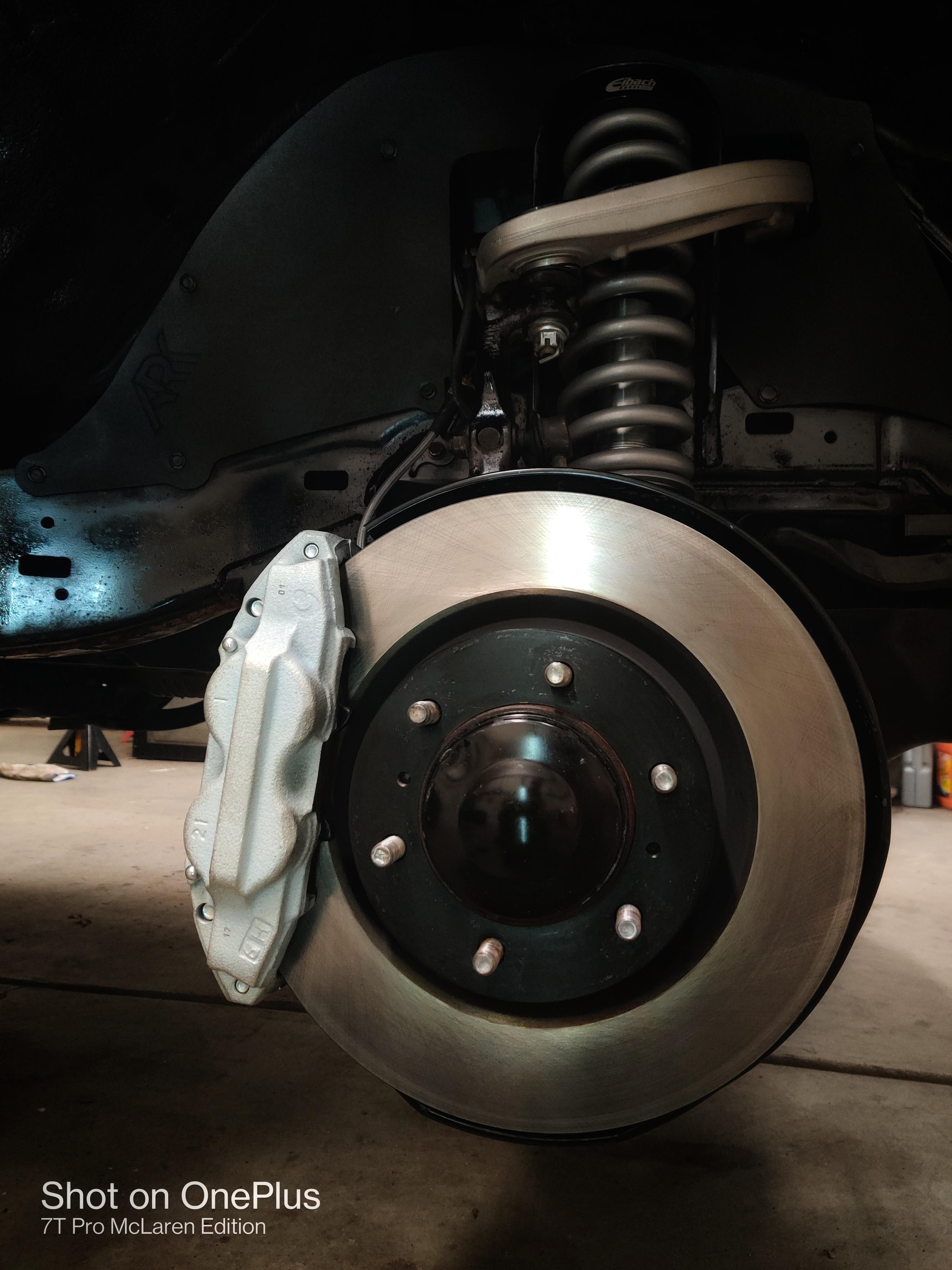

No experience with either, but both are great companies. Not sure if you already looked at the ironman. +4° camber built in, non adjustable. I put some on the FJ last weekend along with Eibach stage 2 coilovers and fifth gen 4runner brake swap. 60mm Dobinson dust caps for the arms perfectly
