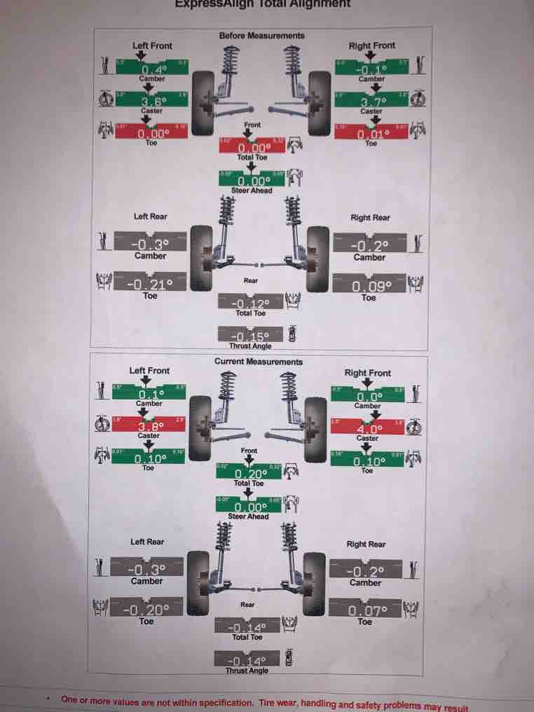

Installed these 2 weeks ago along with Eibach TRD Pro springs. No issues, and I got the extra caster I was looking for. I think they’re a good option for those looking for rubber bushings and a greasable ball joint. Plus, it’s a commonly found ball-joint unlike the Delta Joint or X-Joint.
Not sure what my stock caster was before these UCAs, but here’s what my alignment numbers were: IMG_7820.jpg
Hoping to put on 285/70’s soon if I can find the tires I want in stock.
