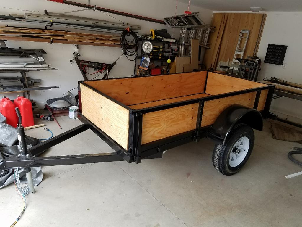

If you want to come to Utah and get it I'll sell you mine for $1500. For $2000 I'll build a roof rack any height you want and swap to sr5 wheels/tires.
