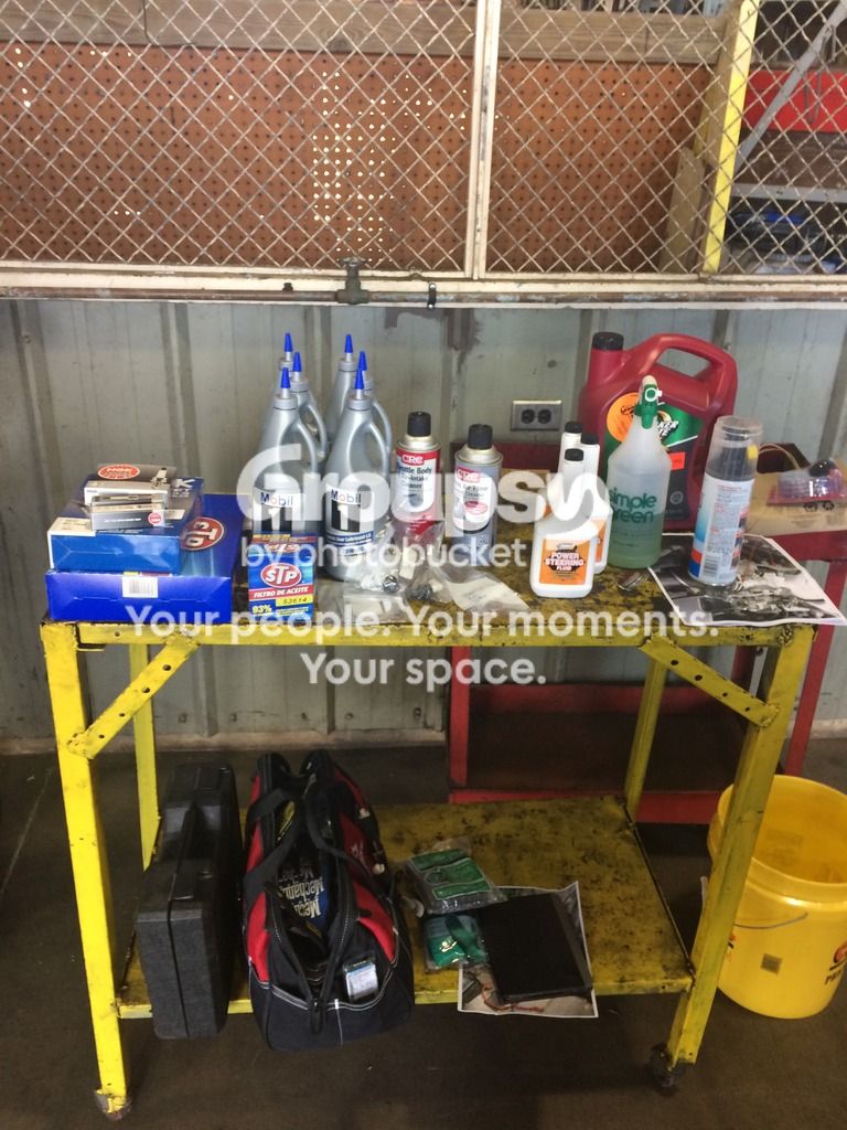

Aloha- Today I cleaned MAF, Throttle Body, replaced PCV, Grommet, front/rear diff oil, transfer oil, motor oil, power steering fluid, plugs, wires, and recharged A/C.
IMG_1914_zpsmmnoulmh.jpg~original
supplies;

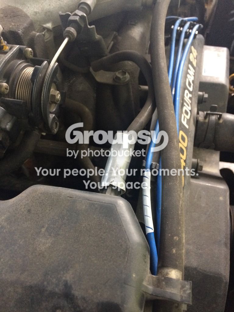

cleaned throttle body;

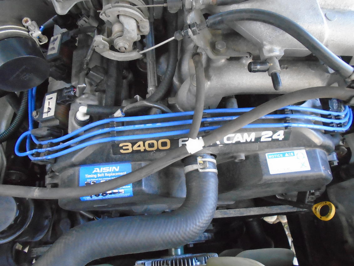

what hose is this?

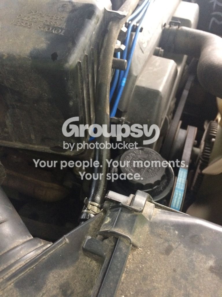

and this?

No one knows the name of those 2 hoses?
Subbed to figure out what that duct taped hose is, mine's just like it but with electrical tape. :)
Sent from my SM-G900V using Tapatalk
According to the tsm illustrations..the hose that's attached to the back of the air chamber (the one with the duct tape) is an air hose for the air chamber. What that means idk, that's what's labeled in the manual.
And the other hose that goes to the back of the filter housing (the hose with the clamp on) is a evap hose. Got something got to do with the evap circuit.

Sh!t Dude, I'm going to be the bearer of bad news - possibly.
Is that Power Steering Fluid I see on the table? I hope that's for another car. The 4runner calls for ATF in the power steering system. I believe others have reported issues using PS Fluid. Noisy pump??
I'd get a second opinion for sure (in case I am mistaken) and then I would flush the system well with ATF. You don't want to be ruining steering components.
yea, atf for ps fluid.
Yes. I just went and read the power steering fluid cap. Cap says "power steering fluid" then in smaller letters underneath it says "use dextrin type ATF"
Plus after my daughter drove it today she said the steering wheel was a lot harder to turn.
How can the parts department at a TOYOTA dealership not know that? I guess I'll be doing it again tomorrow....:wtf:
Thanks Kanoe for noticing!
The hoses you show are:
IMG_1922_zpsevycbgm3.jpg~original
Evap system vent hose
This returns fuel fumes into the intake from the gas tank
IMG_1921_zpsyy2djxsp.jpg~original
EDIT: I am wrong about this one with the tape, my mistake
WAS: Intake manifold full vacuum
Truck will idle poorly with this hose disconnected

those are both atmospheric lines, im a less is more guy, I ditched the resonator boxes, the two lines to the power steering pump and tee'd the fuel pressure regulator line into the airbox to charcoal canister hose.
