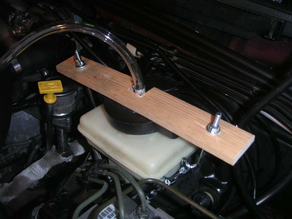

I have used my Motive power bleeder on a Corolla, Land Rover, and a couple different mustangs. For the land rover I built an attachment to get the securing chains out further for a better seal. Similar to this picture:
But the master cylinder reservoir on the 5th gen has even more stuff around it and in the way.

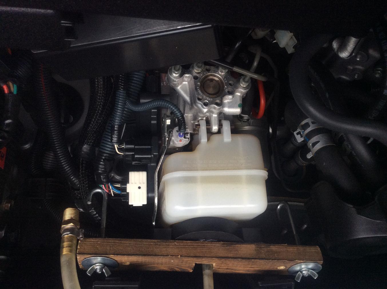

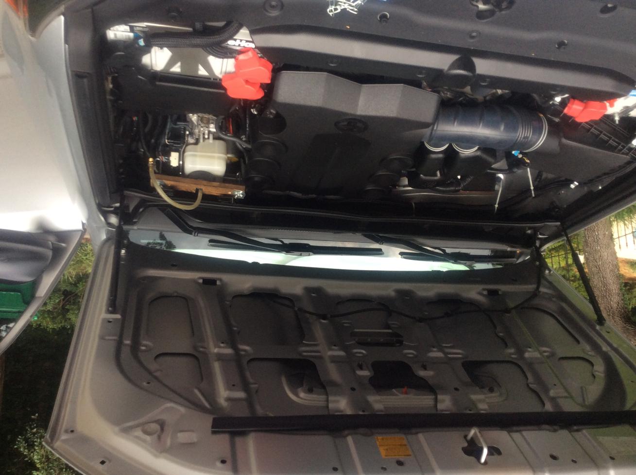

So i decided to go out to the garage and try a test fit. It looks like it could / will work, but may be a pita to get the chain around and not crush anything important in the process.

I have a Motive bleeder and it's worked well on many vehicles, but I would think twice about using it on the MC's with integrated ABS that Toyota uses nowadays.
