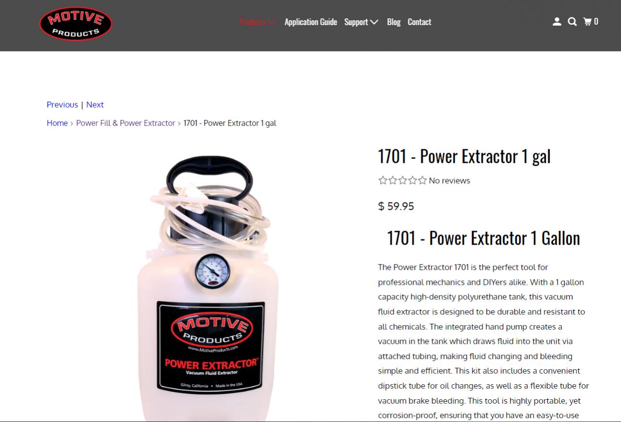

I have a Motive Extractor and it is a lot easier than the pressure bleeders. On the 4Runner it's only needed for the front. I also suction out most of the old fluid from the master cylinder with it. If you have other vehicles it may be worth the cost.
I use DOT 4 synthetic fluid.

what master cylinder part number did you need for the adapter?
No adapter, it does not connect to the master cylinder.
The vacuum line from the container is connected to each caliper bleed screw and the brake fluid is drawn out through the system.
I also use the vacuum line to draw from the bottom of the master cylinder to remove most but not all of the brake fluid. It can be used for the power steering pump reservoir too.
Link to instructions - Extractor Instructions - Motive Products

I'm confused. No adapter needed.
The extractor does not connect to the master cylinder, only to the brake bleed screws through plastic tubing. It draws out the fluid from the system into its tank. I also use the tubing to remove fluid from the master cylinder or power steering pump.
@whippersnapper00 - Did not know about the power filler, looks good, may get one. Better than the small hand pump on top of the bottles. - Thanks.
Their kits are meant to pressure bleed instead of suction (negative pressure) bleed. Using it the way you do basically makes it like a Mityvac bleed system. There's nothing wrong with that method though.
