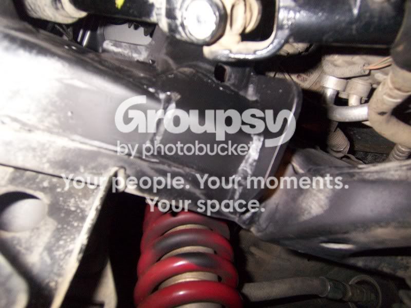

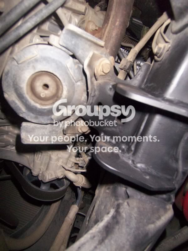

It looks like most guys actually just lift the engine back into place, which pops the motor mount into the correct place, reweld it and some add extra gusseting. My truck is currently at DMZ Fab, a SoCal off road race/fab shop who did a lot of repairs on the TTORA guys trucks, and they are repairing, reenforcing and gusseting the motor mounts/frame, its not cheap but will be far less than $12,000!! I can weld, but for something like this, I would much rather leave it to the professionals.
Here is a pic of the what the damage looks like (not my truck but same thing) as well as the work done by DMZ.
DSC07048.jpg~original
DSC07049.jpg~original
100_2234.jpg~original
100_2237.jpg~original

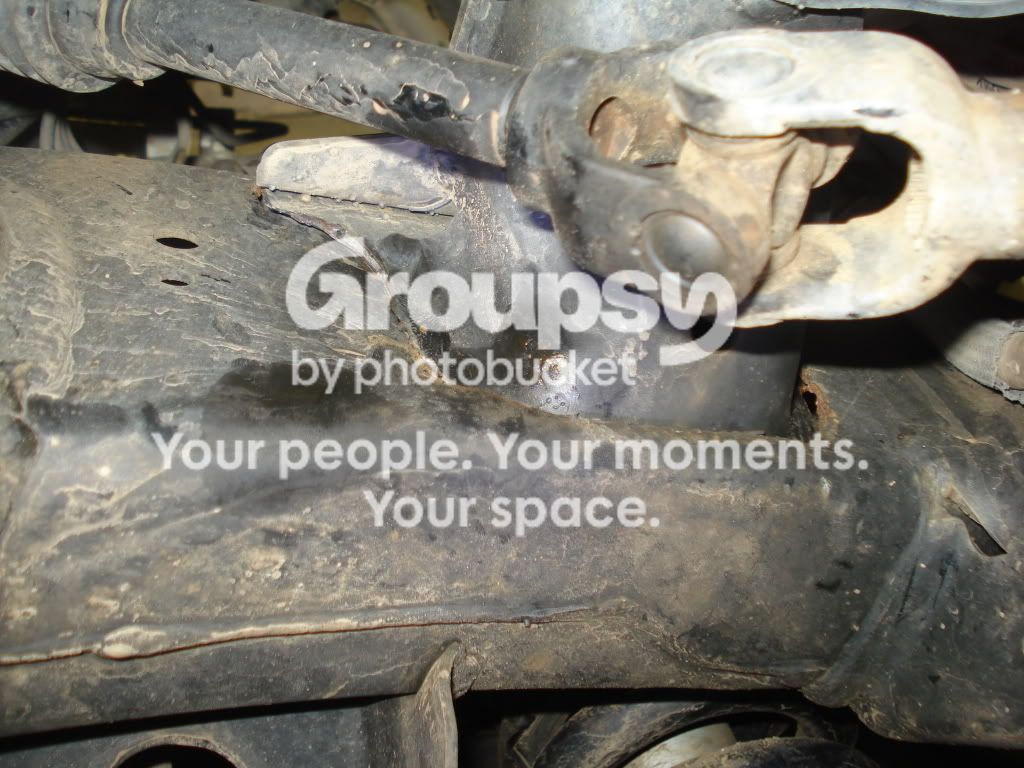

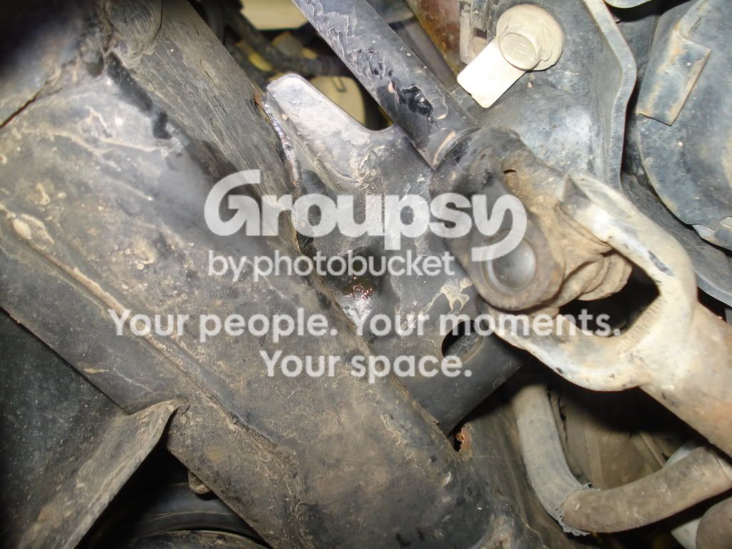

Just another update, I got the truck back from DMZ today, I checked out their welds quickly and they do great work. It was a wonderful shop to work with and I highly recommend them. I just stood there drooling over some of the trucks that they were currently building.
It ended up being slightly more than the initial estimate as the passenger side had also began to cave in, but in total is was only $750, which was reasonable. It took them less than 24 hrs from when the vehicle arrived at their shop to have the truck fixed and ready to go. I also picked up and installed my newest mod today, a Bajarack with a light cage.
