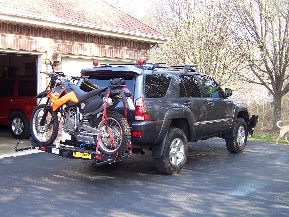

I guess it would depend on the size of bike you got. I run a rack called the Versa-Hauler. Perfect for the 275bl KTM but I would not put the 500lb VMax in it. It's great, slips right in the hitch. Never had a problem. I did add some air bags then upgraded to some OME springs. So nice I forget it's there. I have see some that just fit under the skid plate and you bolt the bike down. think it's called Moto Jack??Mine has a ramp and supports both wheels with 4 straps - I run a geek strap from one frame rail throught the bikes frame to the tow loop - I figure if I evere loose the bike I will drag it?
You can also see that I run a set of break and turns up top because the bike kind of blocks them a bit.
