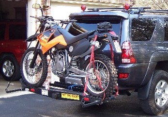

A buddy of mine actually has one and it works great. He has a '99 4Runner, so I'm sure any newer model would have no problem with the tongue weight. I think he posts on here, so I'll see if he can give you some more info.
Versa Hauler
