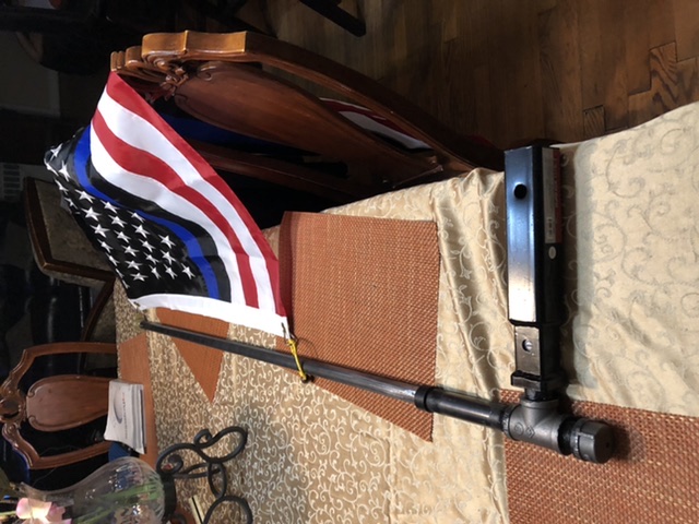

I used a 2" x1 1/4 hitch adapter. 1" pipe nipples plus a T. Flag on a 60" black pipe.
