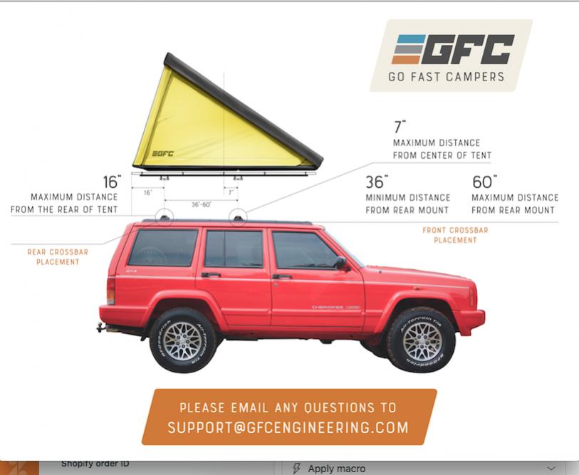

I got a response from GFC pretty quickly with a diagram explaining their required load/spread. I don't have my LFD bars (yet), but I can take some measurements when they arrive.

This photo really surprised me, but it seems to suggest that the go fast tent can withstand being mounted to less than a full length rack.
Personally I wouldn't trust it for the reasons I mentioned in my last post, but you should consider the manufacturer's word over my armchair opinion...

This tent is intended to run with a bare-bones rack and only weighs 80 lbs.
For sure, I'm not arguing that point at all, if anything I'm suggesting that in their quest to make it as light as possible, go fast may have not given it the internal structure that would allow it to be cantilevered off a shorty rack, and driven around at highway speeds with the wind trying to lever it upwards where it is not bolted to a rack. Instead relying on the rack to give the tent base more rigidity.
..... But, I don't know that for sure. The photo that you posted seems to suggest that this tent should be fine of a short rack.

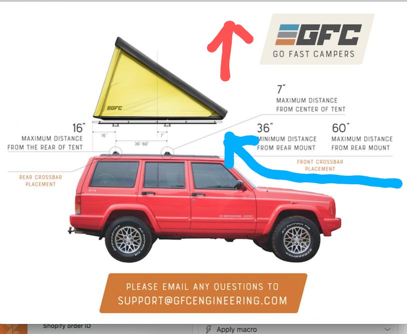

Imagine the wind (in blue) is going to push up on the under side of the tent as you drive. The force (in red) is going to want to rip it up, off your roof. Because the front mount is so far back, this force has a fair bit of leverage and because the tent is designed firstly to be as light as possible, the force from the wind could bend the tent or damage the mounts.
Pushing the front mount forward (by using a full length rack) will counteract this force and reduce the lever action.
The risk is conjecture on my part because I'm not familiar with how this specific tent is constructed, but the physics is sound. It could be that it will handle the force just fine, but I don't think I would risk it.
