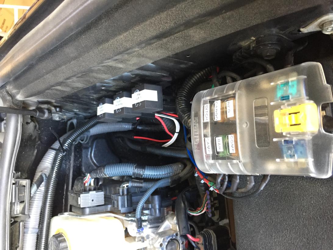

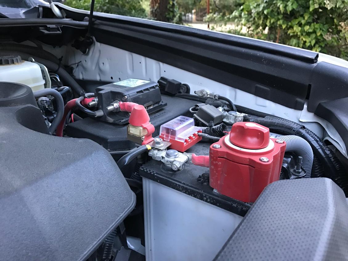

Well, I mounted a blue sea acr on top of the factory fuse box. I tried to use the Shrockworks battery tray/acr mount but Toyota changed some things in the 2016 enough to make their product not work. Speaking of which I should probably get that shipped back to them.
I use 3M Dual Lock type velcro and it works excellent, no play from the "fuzzy" side that you get with normal velcro. I used a terminal stud fuse and with the way it wires up it's just one bolt to disconnect to get the factory fuse lid off. I played around with the cutting board material but it was going to be harder to service tucked in where it was, namely cause I've got a second in-line fuse after the acr, and a battery disconnect switch for my winch. Needless to say it was getting cluttered under there and this method worked for now, but I'm not opposed to changing it if something better comes along. I should really start a build thread.

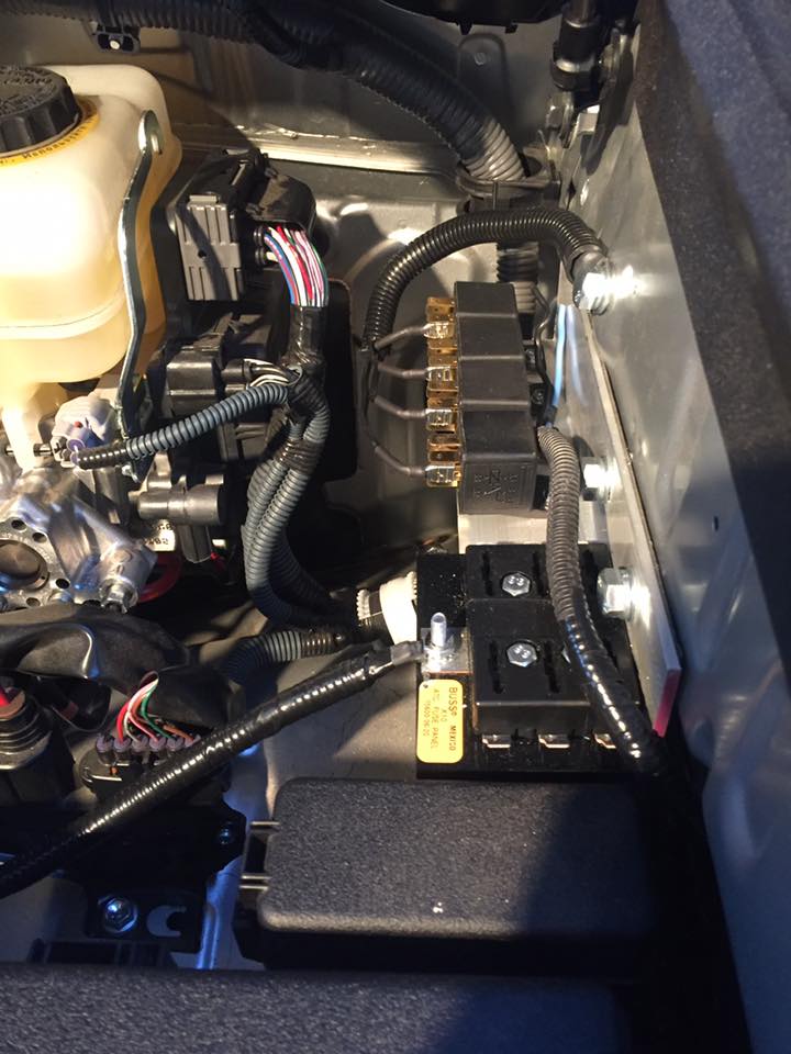

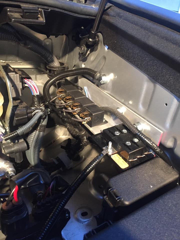

A simple L bracket cut down and painted. It's bolted to an existing threaded nut. Clean and out of the way. Of course I have more things connected to it today.

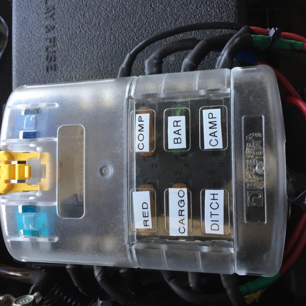

This is my current temporary setup. However, it is only attached with 3M Foam Tape (the stuff from my GoPro). I will be moving it to a platform once I rig one up. For now it works well, is very sturdy, and I can access all the fuses and relays beneath it without issue. The biggest thing to remember when doing this? All wires need to be long enough or flexible enough to open the fuse/relay panel. Wiring all from one side helps tremendously.
