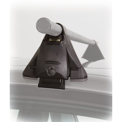

After some more online research, I've determined I have the Q Towers, and if I want to mount to the existing tracks, I need the Control Towers.
So, anyone mount these via the Q Towers, and how did that work for placement? Since I'll be carrying a 15' Kayak on top, having the crossbars centered in the middle of the vehicle would be the most advantageous.
Thanks!

My understanding is that you are correct - if you are mounting them to the factory rails.
If you are mounting to the door jam you can use QTowers.
