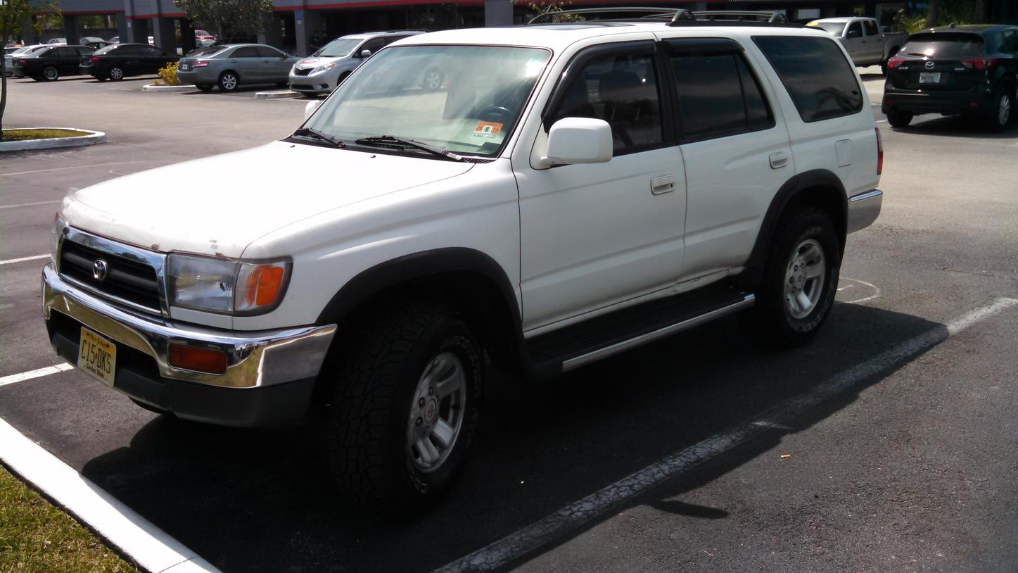

:nono: With heavy heart I finally had to bid adieu to my runner. This was the last picture I had with me.
