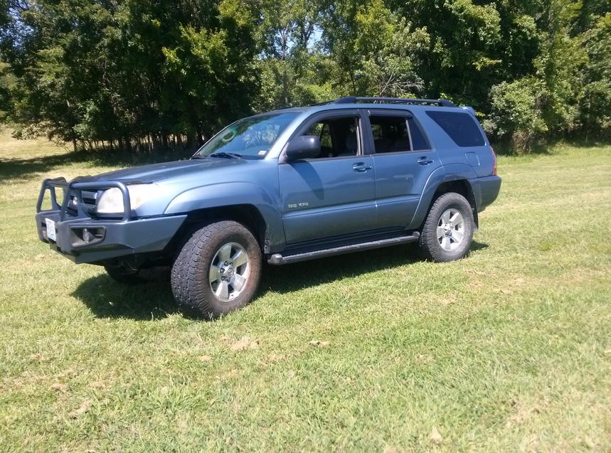

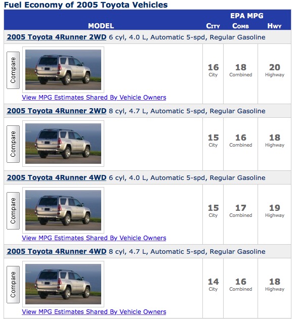

These mpg threads pop up regularly and always make me wonder if the buyer had any idea what he was buying. As a reminder take a look at what the EPA estimates (always higher than reality) are.
