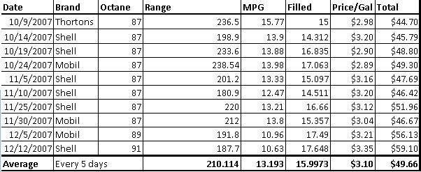

When I bought the '95 4Runner I knew the 3.0 sucked gas, but not this bad. I used to get about 15, now I get 10. Check out my spread sheet.
What do you guys think? Any inexpensive way to improve it? Sea foam, PVC Valve, fuel filter? lol I have those in the back of my truck.
I go the same route everyday, same speed never go above 2.65k RPM while accelerating. Can't spend ALOT of money, I'm in HS, so choices are limited. I'm thinking Seafoam the crap outta it, new sparks, wires, oil, fuel filter. Tires are most defiantly out of the question, no way can I afford that right now, and I don't need them, there are 4 new Goodyear Wrangler RT/S LT/C range, and one B range? I thought that was really odd, I wanna wither switch out that one or the others. Granted I could save MPG's and a crappy ride if I change them, I was planning on either Firestone Destination AT or General Grabber ATII.
New air filter already, no manual hubs, only ADD, and my pass side CV axle is shot, but I have a new one sitting in my garage waiting to be installed.

Correct me if i am wrong, but i think that during the winter months, the gas companies put in a special formulation into their gasoline. This helps the northerners for some reason (i forgot), but the special formulation decreasese fuel economy. I have always noticed this during the winter months...all my cars are less fuel efficient.
Found it: (from chevron website)
"Oxygenated gasoline is a mixture of conventional gasoline and one or more combustible liquids which contain oxygen. At present, ethanol is the most common oxygenate in the United States. The government requires gasoline to be oxygenated during the winter in areas that have a carbon monoxide pollution problem (cold weather and atmospheric inversions worsen carbon monoxide pollution). Oxygenated gasoline helps engines run leaner, which helps some engines
I've seen postings that say cleaning the mass air flow (MAF) sensor is supposed to help fuel economy a little bit.
A search should turn up instructions on how to do it. It's the sensor in the air intake, right behind the air filter box, so access to it is a snap. The process involves cleaning it very carefully with electrical contact cleaner, as the business part of the sensor is essentially two tiny bare wires.
I've also heard of people proactively changing the oxygen sensors even if the CEL isn't on in order to improve MPG. Both the MAF and the O2 sensors control the air/fuel mix, so if they're feeding the computer bad data, it could be burning more fuel than necessary.
For me its what Thai says. I ALWAYS have noticed crappy fuel economy in all the cars I've owned during the brutal winters up here. I've never put Seafoam into anything fuel injected before, I guess I'm yella. If anyone does, please tell us about it.

Check your tire pressures....a 10degree difference in ambient temps from when you filled them last can have a 1-2psi change.
Also, tires loose pressure at the rate of about of 1psi/month
A loss of about 6psi can increase fuel consumption upto about 5%
Alignment is another area where energy can be lost
Swapping out the diff and transfer case with new and higher performance fluid can also net you a 1-2mpg increase. I swapped over to Royal Purple and saw an increase.
Check your fuel filter and spark plug gaps...

1. MAF cleaner (about $3.50 at a autoparts store) as that can net you a good increase if its dirty as well.
2. O2 sensor might be bad.
Thai also has it correct, oxygenated fuels are used in the winter which help reduce emisions but also reduce economy. In addition, the higher density (colder air) of the winter months also means that you're vehicle must increase fuel flow to meet the proper A/F ratio.
I use seafoam in the 4runner every 15K miles. Probably not required but since i dont use premium grade fuels (but i do use Chevron and Shell fuels), its a cheap and easy way to at least "feel" like im doing something. I also use it in my Gf's VW Golf whos mileage went up about 2mpg after the first treatment that i used on her car. She is quickly approaching another interval.
I noticed that your mileage decreased when you used higher octane gas. You'll never improve your mileage enough with higher octane gas to justify the extra cost anyway. I get about 10% less per gallon when I use 10% ethanol gas. Hope I helped.
Fix your CV shaft, it causing more drag on your drivetrain. which reduces your MPG
Get Manual hubs... the "locked hubs" have your front driveshaft spinning when your in 2wd. more drag, reduced more mpg.
switch to synthetic fluids... they claim better protection and less friction. I can agree on the less friction.
In my old 94 4runner with 3.0 and 5 sp; 4:10 gears, 3" lift, 33x10.5.
I switched to manual hubs, I gained 2-3 mpg.
I switch to redline gear oil and I gained 2-3mpg.
After that I was getting 16-19 mpg on the highway doing 65-75 mph.
Thanks for the response guys. I've know about winter fuel mixes and their decrease in MPG (from T4R.org coincidentally), but I just haven't seem a big impact like this before. There is no MAF on the 3.0 unfortunately, it is a MAFV, a mass air flow valve, nothing to clean there. I'm probably gonna seafoam the hell out of it, change the oil & filter, change the fuel filter (came with the car), and the PVC valve (also came with the car), and if I still see no results, I'll dish out the dinero for the O2 sensor. I'll check the PSI again, just to be sure, quick question though, if the max PSI in my LT tires is 45, what should it be at?

Man, I wish I had the 5 spd, the Auto on these this Toyota, although bulletproof, sucks up gas.
See, I have 4.88 gears riding on 31x10.50 . Once I save a little money, I plan on switching to manual hubs and adding a lift. Synthetic is on it's way, as it is already over 3,500k from the previous owners oil change, I love Amsoil, but can't afford it so I use Mobil1.

Okay, just went and checked the tires. 3@ 34 PSI with a max of 50 bumped to 40, and one @ 29 with a max (cold) of 35, bumped to 35.

Quick update. MPG still sucks with new CV.
Has the Valve Clearance been confirmed to be correct? At 90k it's probably time to check it. Just 'cause it's quiet doesn't mean it's ok. Too little valve clearance will hold a valve open slightly reducing power/economy and ultimately it'll cause valve damage.
O2 sensors get old. That would be my next guess. Good luck! :cheers:
