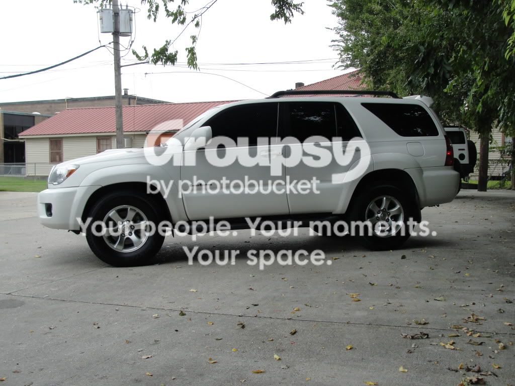

Here she is all cleaned up

Also I never got a spare right now because the tire has yet to be used thats there, so I figured it can stay and save some cash.
Nice. Mine is also white with tinted windows. So I guess your spare is a mismatched size? Anyway, thanks for the info on those tires. I'm torn between those and the Hankook Dynapro ATMs.
