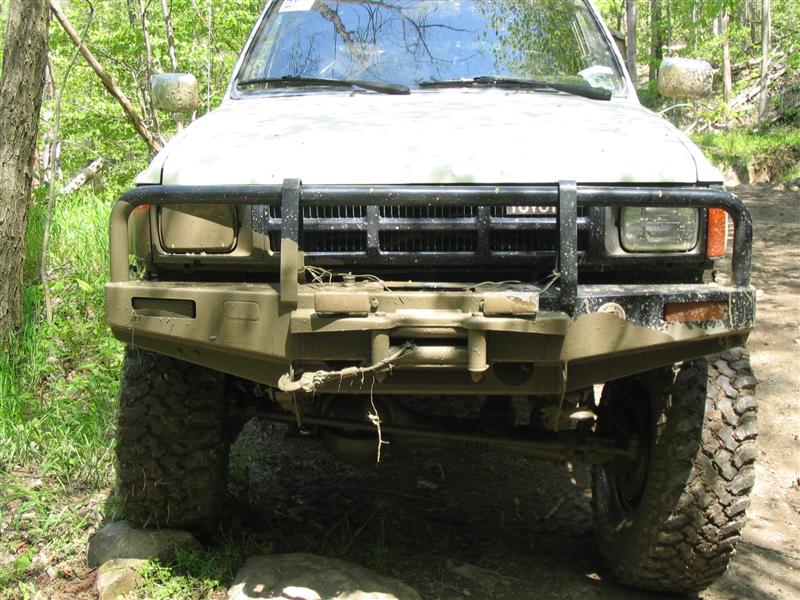

In 2004, I replaced the wimpy Toy alternator in my '85 4runner with a Powermaster 47294 140 amp 10si-type alternator. Even though it's been water and mud - see the pic below for one example - it's worked great for over 6 years.
Good luck.
Al
