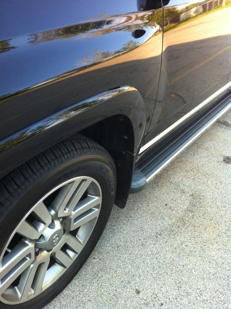

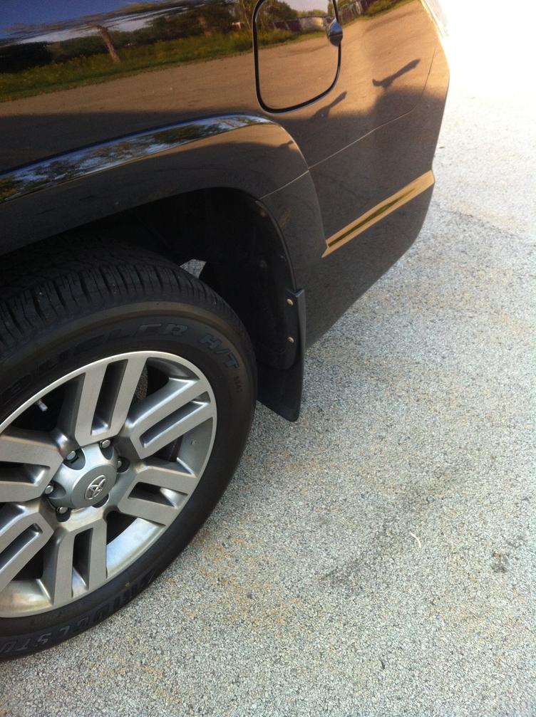

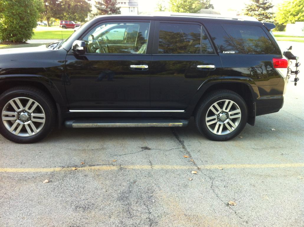

Sorry for the delay in the PIC's. It has been crazy week. Now you could drill holes for sure if you want, I did not. They are mounted on there just fine with out having to drill holes for the bottom mounts. Now on the front flaps you certainly could drill for the top mount and the bottom one. Again, I did not since the flap was on there secure enough. As you can see there is plenty of room with running boards there.
Now I have done 2 Winters up here with these on and trust me they are fine without drilling holes. If you saw any of the news you know we got hammered last year in Upstate NY.

I have the exact same 4runner and boards. I installed these just fine.
Amazon.com: Genuine Toyota Accessories PT769-89110 Mudguard: Automotive
I have no issues at all running these. I put them on because I was tired of the salt rocks cutting up the clear coat.
If you want I can post you some pics of them later.
Got the same setup, installed boards/flaps as soon as I brought the truck home 2 1/2 years ago...........no issues at all, no holes drilled!
OP, one tip when mounting front flaps, if flap doesn't clear board, simply loosen the six nuts that secure board to mounting brackets and slide it back as they are adjustable. Retighten nuts, you're good to go.

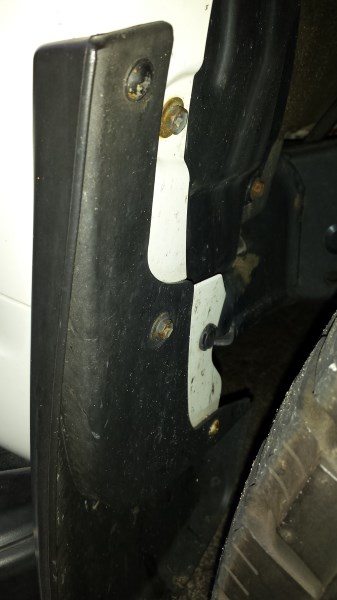

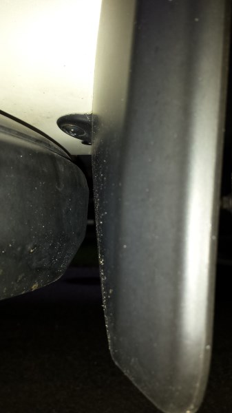

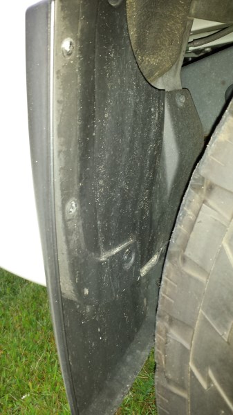

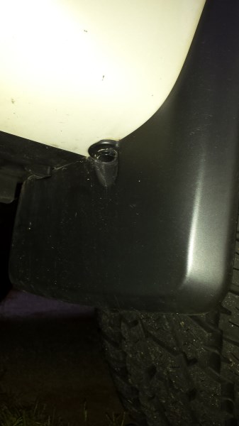

So question for you. Looks like the front flaps will only be secured by two screws if you don't drill out the other two holes. Did you leave it that way?
Edit: Found the installation procedures for these btw.
http://www.trdsparks.com/install/PT769-89110inst.pdf
so question for you. Looks like the front flaps will only be secured by two screws if you don't drill out the other two holes. Did you leave it that way?
http://www.trdsparks.com/install/pt769-89110inst.pdf
You could drill for upper screws, but because you're screwing into plastic flare, I just used a cordless screw gun to run them in.
