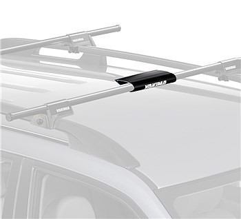

I 100% believe that. The flat round bar up top has nothing to disrupt turbulence. So it makes more noise and likely to whistle. The light bar makes the air flow differently which equals less noise.
If you look back at round bar Yakima setups they made a little fin that would clip onto the bar to clean up the air and make it quieter.
here I found a photo of this. I am sure it would work on the Gobi rack also to cut down on some noise.
Nice! Thanks, I may check that out.

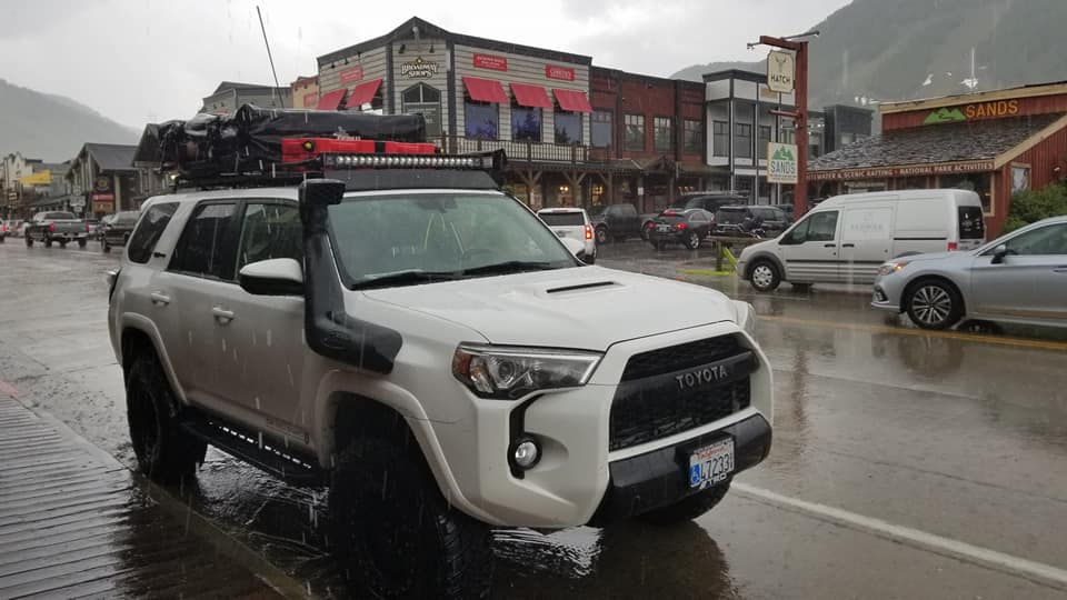

Im going with the multi light setup next time, I have the single row light bar mounted on the Gobi rack now and hate the way the light reflects off the hood. Way too bright at night.
Hi,
Is that the no-rise Gobi option? Im in the process of ordering now. Also, how did you attach the maxtrax and tent?
Wrap a rope around it similar to what you see on some vehicle antennas. This should eliminate the noise.
Mine doesn’t make any noise, maybe because it’s not smooth due to the Line-X.

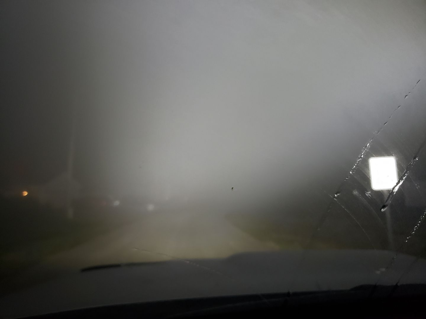

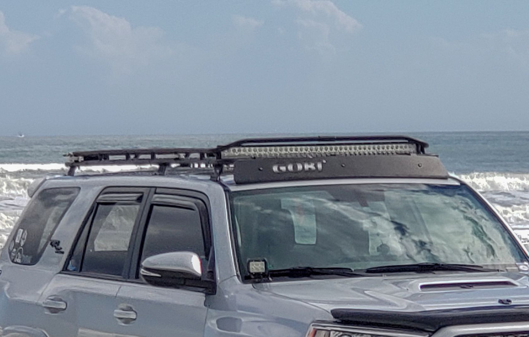

I have only run my rack with this 40" bar installed. I have not experienced any whistle or extra noise with it in this location..
Having it here, I do lose some light output because of the deflector, but a bonus has been no excess reflection off the hood when it is on.
Very foggy night

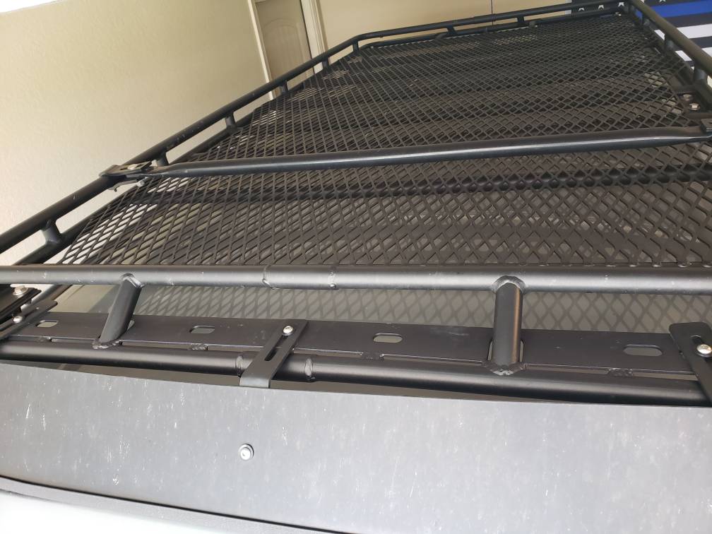

1) I am not seeing the stealth (no front riser bar) option on the website. Is that a "must call" feature? Yes, fairing is included with the rack. I recommend the removable crossbars. I didn't really like them as they sat too low when using for out RTT. I picked up some Yakima Rail Grabs and round bars so I could get my hands underneath it.
2) Do the stealth racks still make it easy to put multi-light setups on top? Yes, if you order the multiple light configuration they have plates in between the vertical support bars.
3) Are there mounts to put directional spots on the back corner(s)? Yes, they have the mounting spots like the front, but only on the corners.
4) Are there better light options than the Gobi branded ones?
- I want to have one central light in front, one directional on each front corner, and maybe one on a back corner On their site I'm only seeing Rigid brand. Rigid is one of the top brands out here. Another brand to consider would be Baja Designs.
5) Is it tricky self-installing the lights? In terms of running power? Not terribly tricky, no. There are a few ways to do it, but you could just run the wiring down the A-pillar (underneath the trim) and down into the engine bay. Run the rear light wiring down the length of the rack and down the A-pillar the same.
6) Am I taking on too much hoping to install all this myself? (I'm pretty handy, but I've never tackled this sort of thing) Installing the rack is easy. Remove the old rack, put in 2 bolts per foot of the Gobi, lift it on top and snug it down. The wiring won't be that bad.
Thanks so much for your help and replies.
Pictured is the multi light configuration
I went 2 Rigid SR series. I honestly wanted to do 4 across, but I have the no rise option and could not figure out a good mounting option unless I got a custom bar made and welded on. I chose separate lights due to different spread options.
I said the same thing in the beginning that I would not put lights on the rack. But here I am.
