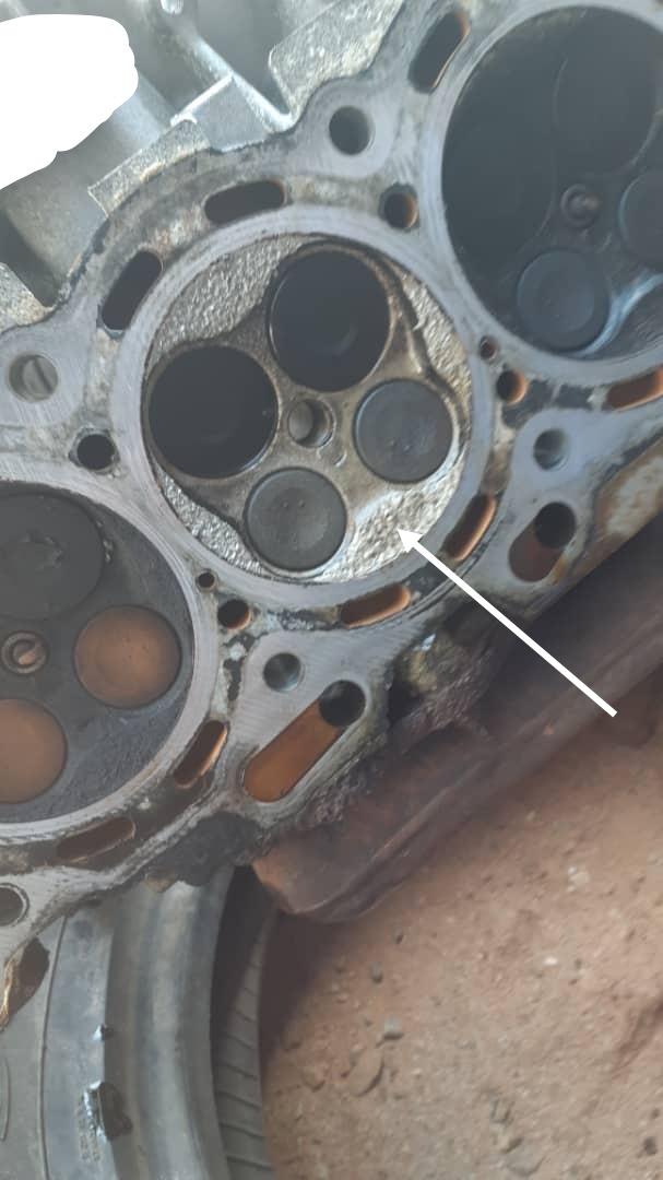

2ndly, attached is pic from the bank 1 cylinder.wonder what would have made the mark there.

Did the mechanic clean that cylinder portion of the head or is that the way it looked when they pulled the head?
Thats the way the cylinder was.scuffed/pitted.

Not sure what could cause the pitting but the clean metal is most likely from when the coolant was turned to steam when the cylinder fired.
The pitting looks like casting marks imo. The other two look blueish which would mean an issue with oil burning, as is indicated by blue exhaust. And if you didn't work out the air bubbles in the cooling system when you filled the tank, you would get some settling in the coolant level. Not to disagree with the mechanic, but I don't really see symptoms of head gasket failure nailed down at this point, but a whole lot of burning oil. And that is a very pricey repair. Now, a combustion chamber flooding with oil will definitely cause the engine to misfire.
I disagree that it doesn't have a blown head gasket, that one cylinder wouldn't be that clean if there wasn't something going on to make it look so pristine and clean as it is compared to the others.
That clean silver cylinder head is the classic sign of head gasket failure.
There's also significant oil infiltration the combustion chamber, and it is a problem unrelated to the head gasket. I think AU Seeker nailed down this one.
